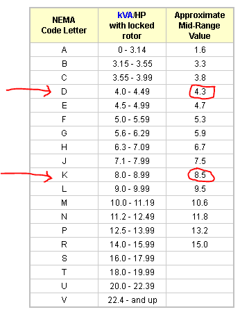

just guessing here at something that could match your observations -
1745 rpm is 3% slip ,,, ##\frac {1800 - 1745}{1800}##
1767 rpm is 1.8% slip
Going to a lower slip motor means it has less rotor resistance so draws more starting current.
Does it have an entry on the namepate called:"NEMA code" or "code" or "kva code" ? It'll be a letter.
Compare the two kva codes
if you've gone (let's just say) from a code D to a code K motor you've almost doubled your starting current
and that could explain why you trip .
see if your electrician can get a current reading before it trips?
