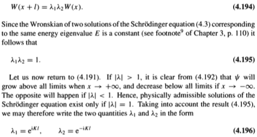

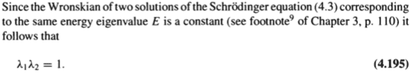

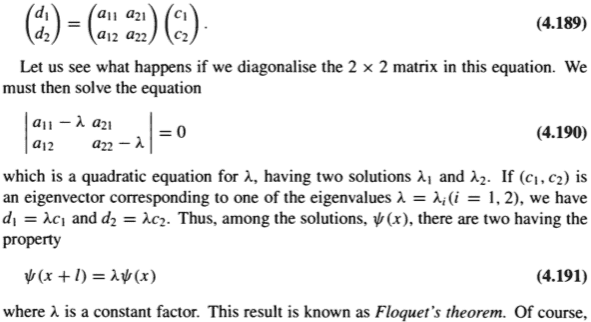

The cause of my confusion is that I believe there are eigenstates of H that are not eigenstates of D. This is confirmed by B&J's paragraph following (4.190).
Consider the simplest case of ##\psi=A\sin (kx)+B\cos (kx)##. The eigenfunctions of D are given by ##A=\pm iB##. So ##\psi=\sin (kx)## is an eigenfunction of H but not of D. The eigenfunctions of D are ##\psi_{\lambda_1}=e^{ikx}## and ##\psi_{\lambda_2}=e^{-ikx}##. And since they have different eigenvalues, a linear combination of these two eigenfunctions will not be an eigenfunction of D in general, and so does not satisfy Bloch's theorem ##\psi(x+a)=e^{iKa}\psi(x)## even though it is always an eigenfunction of H.
  • #44

$$\psi_{\lambda_1}=B\cos(kx)+iB\sin(kx)=e^{ikx}$$
$$D\psi_{\lambda_1}=e^{ik(x+a)}=e^{ika}e^{ikx}$$
So ##e^{ikx}## is an eigenvector of D with eigenvalue ##e^{ika}##.
$$\psi_{\lambda_2}=B\cos(kx)-iB\sin(kx)=e^{-ikx}$$
$$D\psi_{\lambda_2}=e^{-ik(x+a)}=e^{-ika}e^{-ikx}$$
So ##e^{-ikx}## is an eigenvector of D with eigenvalue ##e^{-ika}##. The k are all the same, so ##\psi_{\lambda_1}## and ##\psi_{\lambda_2}## have the same energy. But ##\frac{\psi_{\lambda_1}-\psi_{\lambda_2}}{2i}=\sin(kx)## is not an eigenfunction of D, even though it is an eigenfunction of H.

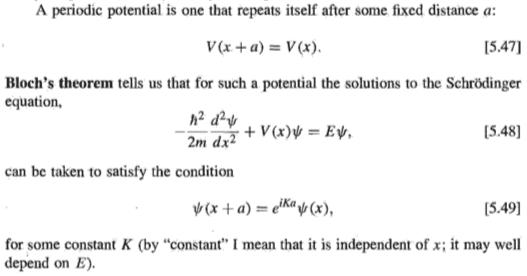

This means [5.48] doesn't imply [5.49]. There exist solutions to [5.48] that are not solutions to [5.49]. This is what I have been saying all along:

No, Bloch's theorem does indeed say that all solutions of [5.48] given that the potential satisfies [5.47] satisfy the condition [5.49].
  • #54
Happiness said:
This means [5.48] doesn't imply [5.49]. There exist solutions to [5.48] that are not solutions to [5.49]. This is what I have been saying:
Huh? No, All solutions to [5.48] are still solutions to [5.49]. [5.49] does not require [itex]\psi[/itex] to be periodic in a. [itex]e^{iKa}[/itex] gives the phase shift between one unit cell and the next one.

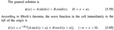

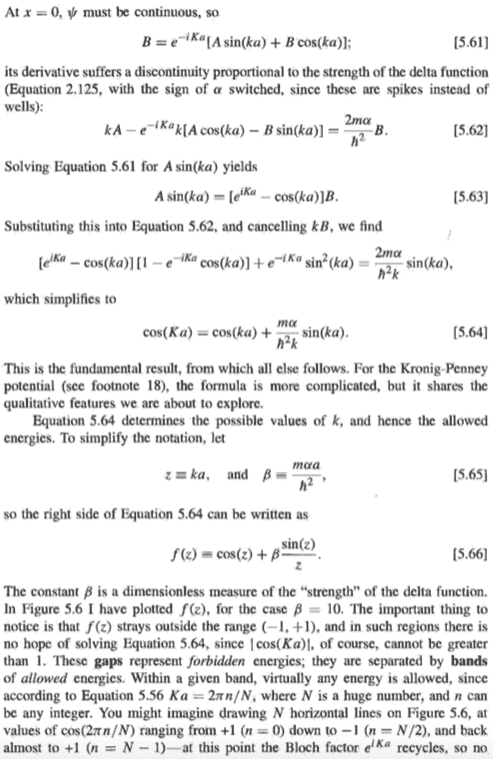

Ok I didn't show an example explicitly as I thought B&J's paragraph following (4.190) is an adequate proof of what I have been saying.
Anyway, you can find one such example from Griffiths:
For each value of K in [5.56], we solve [5.64] graphically. For each K, we draw a horizontal line in Fig 5.6, and we may get several points of intersection. Each point corresponds to an allowed value of k. (K determines the value on the y axis; k is determined from the x coordinate of the point of intersection.) Each allowed k corresponds to two values of K, as you can see from [5.64] that if K is a solution for a particular k, then -K is also a solution (for the same k). Substitute the big K and small k that you get from a point of intersection into [5.63] to get A in terms of B. Substitute this A into [5.59], and after normalisation, we get a value of A and B that satisfy both [5.48] and [5.49] for an allowed value of k. (Actually, we get two values if you remember to include the case for -K.)
But for this allowed value of k, any A and B would have satisfied [5.48] (since k is the same means energy E is the same), but not [5.49].
Therefore, there exists an allowed value of k such that a solution to [5.48] is not a solution to [5.49].

That is not correct. In the band gap region, you arrive at a pair of values of [itex]\lambda[/itex] that is real, but not 1, which corresponds to exponentially growing or decaying modes. Out of these, the decaying mode is usually the physically relevant one.
If you consider the optical equivalent of a periodic potential: a material with periodically structured refractive index, you will find optical band gaps equivalent to the electronic ones. If you shine a light beam in the optical band gap on a (obviously effectively finite size) material structured this way, you will find exactly this exponential decay.
Also, just as a general remark, one should consider that many of the possible superpositions of arbitrary Bloch states will not necessarily be stationary states.
