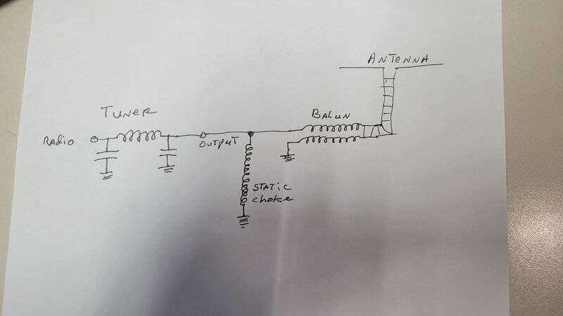

A high frequency wire dipole antenna installed at 80 feet is fed with a balanced line, at the transmitter feed point is a 1:1 balun that the balanced feeline hooks to on one side, a tuner on the other. The 1:1 balun is 12 parallel turns of #12 around a ferrite core. The input to the balun has one leg going direct to ground, grounding one side of the antenna from input to antenna wire. The other side goes to the tuner that is above ground. A 100uh coil is attached to the baluns input that does not go to ground, its function to act as a way for the ungrounded leg to have a discharge path for static buildup, and to look invisible to the RF going across it. Does it have any effect on the Murphy's Law inclination of things that are grounded that seem to attract a strike, meaning, does having that inductor installed really make a difference?

Your essay on the schematic is not so easy to follow. There are too many interpretations. Perhaps you can attach a schematic diagram to your next post.
A static electric charge will build up on the antenna until something breaks down to ground. There needs to be an earth return path for DC from all exposed antenna components. The inductor is such a DC path. I prefer a link across balun centre taps.
A direct lightning strike to the antenna will arc across the inductor before it can build up current through it, so it is wise to provide a couple of external points that can steer the arc away from the components before they are burned in the flash over. A gas filled lightning arrester, (as used on telephone lines), will protect most antenna systems from strikes.

It is very difficult to protect the antenna against lightning unless very heavy conductors are used, with a low resistance earth connection. Maybe the the downcoming open wire feeders can be directly earthed - that would be a good step. Maybe you can arrange them to form a quarter wave stub to give a good DC path to earth. In addition, as in post #2, obviously earth the support masts.
Protection of the radio equipment is best handled in stages, rather than relying on on just a single path to earth. Why not use an ATU circuit using a DC path to earth? Why do you have such a large inductor, it needs only be just enough for RF purposes and needs to be heavily built. Maybe a discharge device is a better proposition. I am not sure that the radio equipment will be safe with a direct strike whatever you do, because the current is possibly 10^4 Amps. Commercial lightning protection systems use conductors of 50 mm^2 cross section.

My Murphy's Law comment was due to an experience at a facility where $30,000 was expended for a lighting protection system, installed on a 50 ft steel tower, 2 air terminals at the top, each on a separate Thompson Lightning woven cable, bonded every so many feet to the tower, and attached to ground rounds, all connected by 500MCM with ground rods every 10 feet, including the perimeter of the building, all exothermically welded, a ground system resistance of 4 ohms (took a lot of rods and pretty good for rocky soil) and a direct strike turned the equipment inside the shelter into a $180,000 charcoal briquette.
My one on one with a direct strike on a facility I was in that was also fully 'protected', was the room took on a blue caste and the air in the room became warm instantly. The schematic of the circuit is attached. Basically a 100uh (approx) coil to ground, a 100 turns #16 enameled wire on a 1/1/4inch form and the XL high enough that the coil is invisible to the 1.8 to 30Mhz energy going across it. The spark gap recommendation was noted, and now has been implemented. Started with .020 inch gap, we'll see what happens.

I believe that the rise time of a lightning curent is traditionaly taken as approx 1 uS, and the current might be 10^4 Amps. So the rate of increase of current is 10^4 / 10^-6 = 10^10 Amps/second. For a 100uH inductor the volt drop is then -L dI/dt = - 10^-4 x 10^10 = -10^6 volts. So the inductor will flash over and be destroyed.
