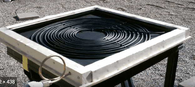

I would like to add a new factors in this discussion of water heating to remind everyone to remember minority use cases and not just mainstream use cases. The topic of heating water can be very broad.
I live in an RV with 1500 watts electric service. To use the AC I need to shut the hot water off.
I was considering a DIY solar HW heater project.
But that needs a circulation pump, plus a way to prevent overheating/overpressurization, and a way to drain it when I leave for the winter to prevent freezing, or to fill it with antifreeze and use an intermediate heat exchanger. The complexity adds up fast. My DIY skills and DIY tools are very limited.
Instead, I intend to use the existing water heater's solutions for all those problems. I plan to get a 200 watt solar panel, plus an inverter. I'll swap the 1200w resistive heating element for a 150w element. Then I can disconnect the entire system from the grid and feed it from the inverter. No parallelization of inverter and grid. No mains electric. No safety problems with rewiring the internals of a water heater. I'm not concerned with fast HW recovery, or about running out of HW during the night.
We also lived on a sailboat for 12 years. We had no HW tank. In those years, we found that a sun shower was a delightful source of hot water for showers. It heats up in only 30 minutes at midday. And showering on deck in a bathing suit with the bright sunlight and open air feels good. In places like The Bahamas, fresh water is scarce. The Sun Shower also had the benefit of saving fresh water. 4-6 liters was ample for one shower.
Likes OmCheeto, DaveE, russ_watters and 1 other person
