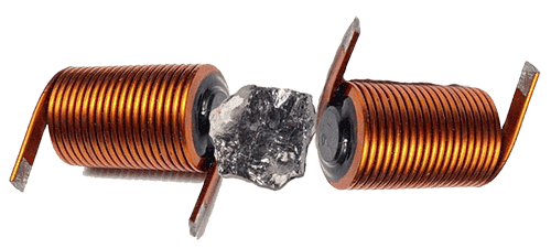

I am working on a project that is inductive heating using two coils and some simplified current control circuitry that can drive coils 10-100kHz.
I have some questions around the magnetic fields and localized eddy currents.
Let me set up the application, then I will get to my questions.
Large ceramic disc about 1.5" thick and about 24" in diameter on a rotary. On the top side the disc has machined casting molds. Each mold will get a room temp slug of lead of proper volume. Inductive heating will melt the lead so it can take shape of the mold.
The idea for coils is to have two of them, "iron" core. One will be held directly over the lead slug, and one held directly below the lead slug on the bottom side of the plate. The coils are driven ontop/offbottom offtop/onbottom. In essence, they flip-flop the magnetic field at 10kHz. Coils are driven so the the magnetic field direction is "the same", into the part (one down into the part, one up into the part), So technically, the eddy current induced in the part changes direction 180deg at frequency, thus heating the lead to melt.
So, my questions are:

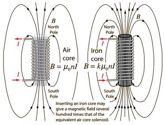

  1. Is iron core coil better than air core for this application when it comes to focusing the magnetic field at the poles as the mag field leaves the ends to wrap around?
  2. Most of the inductive heating coils I see that heat parts, the part is inside the coil. Does inductive heating still work if the part is not inside the coil?

Iron core has "more" magnetic field (higher mag flux) coming straight out the poles, like this? So works better for my application? Coils will be driven around 40 amps (50% duty cycle).

10 kHz to 100 kHz will have skin effects.
In lead the depth will restrict heating to the outside.
Lower frequency eddy currents will penetrate deeper.
So what weight is the lead slug and how deep will the ? kHz heating be?
You might do better melting flat coins of lead than slugs.
A laminated iron core will not work above 10 kHz.
You will need to close the magnetic circuit with an iron powder or a ferrite material.
The device may need to be enclosed in a carefully designed "reflective" copper stove or hood so the radiation stays in the oven volume. That may reduce the need for the magnetic core.

I think there is one hidden problem with this more open geometry. The actual field (and hence the induced heating rate) will depend more strongly on the exact shape and size of the sample. If different molds are sequentially within one disc, each may heat differently even with the same electrical input. Care will be needed.
@MagneticMagic I would suggest using the coils in one of the axis , say top-bottom and then additionally using a small motor that has a powerful neodymium magnet attached to it's rotor, such a rotating strong B field would help to stir the already molten parts of the metal to make the whole mold more even during melting.

You do not need a magnetic core for your coils , yes the field will be weaker that way but as long as you can put the metal within the coil it will work, like see induction heating clips on youtube, they usually have an air coil and put the metal inside the coil, Your coil will most likely need water cooling so it is convenient to make it out of a copper plumbing tube. Depending on how big your mold is you can think about this idea.

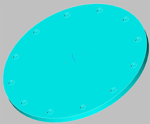

I will make share a CAD illustration of the mold and disk. With a disk I can't get the metal inside the coil.

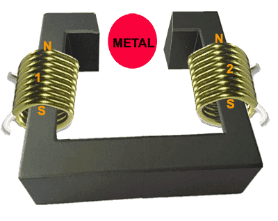

As for controlling mag field, I initially had something like this. My concern here was, kinda looks like a isolation transformer, and I did not want to couple the two coils. Wondering is wrapping the coils with mu metal would help to block the transformer effect?
Sorry, that makes no sense to me. Of course you want to have the coils working together. You show opposing North ends, but you should reverse the notation on the right coil so that a current through both coils generates the same field direction. You want a net B-field to go through your sample, right?
The coils are not 'on' at the same time. Opposed coils is what it should be, heating by eddy current happens by flipping the eddy current direction in the part, this mean you need flipping magnetic field vector. To do that with two coils driven 50% PWM the only way to flip the mag field in the part is to drive N pole into the part from one side (left), then drive N pole into the part from the other side (right) of the part. In other words, two mag field vectors 180deg from each other, but they don't exist at the same time.
Electrically, I am taking the typical induction heater single coil driven by AC and creating the same using DC and two coils. Doing it in DC gives me more flexibility for several other operating parameters.
As for the mold, it's something like this pic. The rotary would rotate the disc and stop when the part is under the coil, dwell some time to melt the metal, then rotate and repeat.

No, that is not how you generate eddy currents. You generate eddy currents by driving a B-field through the metallic part. To maximize the AC B-field, you drive both coils at the same time with the same AC voltage waveform so that they both make the same AC B-field at the same time.

Ideally a single coil would be wound close around the lead slug. If you cannot do that then two coils, one above and one below, in a Helmholtz arrangement, will cause eddy currents in the lead. Those two coils should be in phase, and be tuned to resonance as part of the oscillator.
The way it is now designed is so the field in the middle will alternate with high harmonic content. Turning a coil on and then off is very inefficient. It is much better to tune the coil inductance to resonance with a high voltage capacitor. That way energy not lost to the lead on this cycle will be recirculated to try again on the next cycle. It then does not need a core.
The presence of the lead will slightly lower the inductance, so raise the resonant frequency of the tank circuit, which will not matter if the tank is part of the oscillator. You might consider operating in the 27 MHz ISM band like other induction furnaces, diathermy units and dielectric welders.

@MagneticMagic I'm sorry but you have to update your EM knowledge, you are missing some basic but important steps.
Eddy currents are just circular currents that form on the surface of a conductor if a B field is applied to it that is time varying.
Sure you can just switch one coil at a time but that will be less effective so there is no real reason to do so.The higher the frequency the less the penetration depth that the B field can achieve before it gets blocked by the surface currents, so yes indeed you don't need Mhz frequencies , 10-30 kHz ir fine for most ferrous metals.

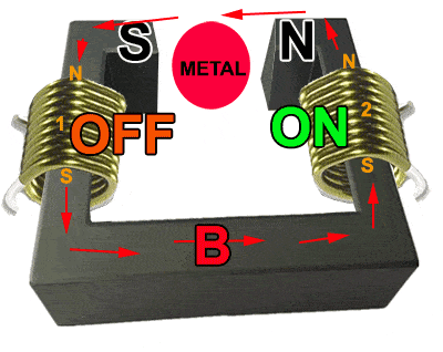

The drive looks like this (animation gify). The faces would always be opposite poles, but the poles flip at freq. And since it's DC drive the B field is always max at any given time.
No luck being used. Magnetics/Physics converted into electrical ckt.
How could the poles not flip at frequency? How can the B field be max at "any given time" if you use switches to switch the current through coils ?
What do you think happens to a DC current as it is being switched through a inductance?
Why do you think @Baluncore suggested the resonant circuit approach?PS. I think I now understand how you look at this , you use two separate coils so that as you switch one coil on it creates a B field that reaches it's maximum at some point and before that point you already switch the other coil on and so the second coil reaches it's maximum B field while the first coil is still on and also has the max B field and only then when the second coil has reached it's max B field you switch the first coil off. also the fields from each coil are the same polarity facing the metal.
1) First of all having such an arrangement will heat the ends of the metal facing the coils more than the middle because the opposing field will cancel out in the middle,
2) Secondly you will need more current because each coil field is opposing the other field and so the total field will be less than what it could be if both coils worked in "unison" with a NS-NS arrangement.
If this is so , then I think it's just a waste of current , the heat within the metal comes from the "change in B field" it's essentially induction, you change the B field and as it changes a circular current is induced on the surface of the metal as the B field tries to enter the metal. The moment the B field becomes static aka doesn't change anymore no more currents are induced.
The idea of the two coils in series with a resonant circuit and a single B field is simple the B field never stops changing (maybe for a brief brief moment during the peak of each half period) and this way you get a continual induction and eddy currents on the surface.
I think your approach is simply worse (less informed) and not as effective , current will be wasted somewhat.

I think I can see what @MagneticMagic is attempting to achieve here.
Since the two coils are on the same magnetic core, the coils will actually appear to be the centre-tapped primary of a transformer, with the metal charge eddy current as the secondary. The primary is driven class B, with 50% duty cycle, by a phase inverted pair of MOSFETs.
It seems that MagneticMagic has reinvented the push-pull transformer coupled output stage, only about 125 years too late to claim novelty.

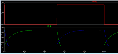

3-4usec is their fall time, slightly slower rise time. Since the two coils are driven 180 out of phase 50% PWM and the "off" time per cycle is ~3-4usec, the B field is "always on". In other words, the B field will very abruptly switch poles very very fast, only takes ~6usec to flip. In a LC tank the flipping of B field is way more gradual per cycle, sine wave gradual. Time wise, with 1kHz drive, full "on" time for each coil per cycle is 1ms/2 - 4usec. So in other words, "always on".
  • #33
So are you talking about dB/dt ?
In AC analysis the B field simply flip flops at some frequency, yet depending on the wave used dB/dt can be very very different. Sine wave is "slow", square wave is "fast". Frequency alone of the B poles flipping is not the whole story.
dB/dt has profound effect on eddy current heating. In sine you have some "avg" (rms) B field over 1/2 cycle, because the B field grows and shrinks to the beat of sine. Let's assume Bmax = 10, so rms would be 0.707, in 1kHz (per half cycle) you get 0.707/0.5ms. Take that to DC PWM where I can switch on/off from Bmax (10) in usec. dB/dt is many magnitudes greater with PWM.
Here's 10kHz. The upper is the PWM drive source, the lower shows the two coils. dB/dt is magnitudes higher than sine wave. Yeah, on is a bit slower than 4usec, darn silicon.

  • #34
So explain in your own words then , what is the benefit in this?
Do you know that a square wave actually has multiple sine wave components/harmonics in it , you will get the combined effect of if you just used a higher sine frequency, trying to "square" everything will also add more heat to the work coil itself.
And yes FET's work in on/off modes naturally but if you will use a sufficiently large coil/inductance your real waveform within the coil will approximate sine anyway, that's just natural you can't escape it.
You are going the opposite way, instead of having a field that constantly varies (yes with slower rises and falls) you want to have a field that quickly jumps up and down but stays static inbetween, if you actually look at the waveform graph you should notice that most of the time within a square wave is spent either at max voltage or no voltage while in sine almost all time is spent in a varying voltage mode.
Whenever the voltage reaches a steady level you essentially have steady current passing through the coil, a steady current does not produce a changing magnetic field so a steady current through the work coil is just wasted current as it does not accomplish any goal.
In induction heating you want to just constantly shuffle a B field back and forth and make it penetrate further into the target metal in the least amount of time so you would look for the most efficient way to do that which consumes least energy in the process of doing so. Resonance here accomplishes just that.
But again as I said maybe I'm dead wrong so you are free to explain and prove your method is better than the ones used by most

@MagneticMagic take no offense but you seem to be one of those people that come ask for advice but then already seem to have an answer and basically just asked the advice out of curiosity?
We told you why your method is less efficient than the one we proposed , explained the "pluses and minuses".
Now if you wish to still do it your way that is fine but then what's the point of asking?
When I said "back and forth" I just meant a B field that constantly changes in strength and flips polarity.
I suggest you try both methods , your as well as the more conventional I think you should see a difference in how fast the heating happens as well as power consumed.
Also remember that heating will be more even if the metal to be heated is within the coil not outside of it, that is simply due to B field divergence outside of coil especially if you place two coils with same polarity back to back, the field will be deflected a lot and here will be no field in the middle only at the very sides, so your not just wasting current your wasting field.

artis said:
... especially if you place two coils with same polarity back to back, the field will be deflected a lot and here will be no field in the middle only at the very sides, ...
If the scheme had been described from the start as a push-pull driver then it would have been more obvious what was meant by the misleading “50% PWM”.
Many in this thread are convinced that the coils are driven opposed in polarity, at the same time, when the coils are in fact powered alternately, so the net field through the magnetic core really is alternating and there is no cancellation, just the reversals of alternation.
  • #41
Right , completely forgot about this one, still in this approach the OP is effectively only heating one end of the metal at a time , he could connect the coils in series and then the whole of the metal would be heated at once irrespective of his waveform but for some reason that is not an option according to OP.
  • #42
See pic in post #25.
Why would I have two coils if I was going to connect them in series NS-NS? I would just wind one coil, no?
Heating one end of the metal? The B field passes through the object. The time to heat object is not in this discussion, having to heat super fast (relatively speaking) is not a factor in my project.
And using adjective words, yes, it's a push-pull design using PWM 50% drive. I can adjust the PWM to get various push-pull characteristics, but 50% drive is easier to do in silicon.
Not just alternately, but also in opposite direction magnetically. I made it clear numerous times that both coils were not 'on' at the same time. So with all due respect to all, not sure if folks are reading the posts, or understanding them.
1st thing is, AC means "alternating current", has no hard ties to voltage.
Lenz laws also tell us the eddy current flips 180deg between +dB/dt and -dB/dt (rise of B field to fall of B field). In other words, in AC, eddy flips 180deg during every 1/2 cycle of AC, or flips twice during every 1 cycle of AC. In DC drive with just one coil, eddy only flips once per cycle. So yes, AC (alternating current = alternating B field, per 1 cycle of drive) = more eddy heating, hence when driving with just DC it's best to create alternating current, which can be done a few ways using silicon.
And to be clear, I could do the basic LC tank with one coil, but my drive circuitry allows for "instant" control of frequency and B field strength, making the drive section way more flexible than an LC tank setup.
And yes, I already understand there's Pros & Cons to everything. More flexibility for less efficiency sometimes makes the solution more attractive. I understand the efficiencies.
Matter of choice
No, a changing B field never passes through a solid metal, that is why the eddy currents form in the first place, they resist the B field that tries to enter the material by creating their own B field which is of opposite polarity , the overall effect is that of a decrease in the primary B field strength. This is induction so think of it like a transformer analogy, your piece of metal is the secondary, just short circuited and a weird shape that it.
As I said having the B field from just one side will create eddies in just one side of the metal you will heat just one side of the metal. B field is not dumb why go through a material if it can loop around and come back to the other side of the coil... B field always forms loops back to it's source.

I would blame the misunderstandings on your cryptic description of an unusual system.
Because you could then put one coil on each side of the lead slug, in Helmoltz configuration to get an even field in the oven.
You should consider driving the inductor in series with a capacitor. That technique is used to reduce driver losses in efficient resonant converters.
Can you please let us have a copy of your file.asc used for the simulation in post #33.
