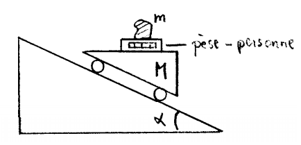

In summary, the homework statement states that a moving vehicle of mass M is moving down an inclined plane of angle alpha with respect to the horizontal plane. There is a force indicated on the scale which is written as pèse-personne between M and m.

A moving vehicle of mass M is moving down an inclined plane of angle alpha with respect to the horizontal plane. What is the force indicated on the scale ?
It is written pèse-personne between M and m. That's a scale (to weight people)

I started to try to find the acceleration of M on the inclined plane. I have the following forces acting on my moving vehicle : gravity (down), normal force (perpendicular to the inclined plane) and the weight of the mass m (it is not indicated but I assume that the scale doesn't have a mass).
I separated the gravity components in parallel and perpendicular component and I get :
Fg parallel inclined plane = (M+m)g * sin(alpha)
The Fg perpendicular cancels out with normal force. I don't think I need it but that's the same of Fg parllel but with cosine.
Then I have ma = (M+m)g * sin(alpha) which gives me a = g*sin(alpha) * (M/m + 1)
(I can give the steps if needed).
Now I am stuck. How can I find the normal force for m ?
For m, I have the weight (down), the normal force (up), acceleration (right) and inertia (left). Those orientations are with respect to the moving vehicle and not the inclined plane. Am I supposed to break all the components in their parallel and perpendicular (to the inclined plane) components ?
I am confused with this inclined and not inclined plane of the moving vehicle. The exercises we did before was an elevator (for the weight) and a moving vehicle on the horizontal axis (to introduce inertia).

Do you think horizontal motion will affect the reading on the scales?
No, only the gravitational force acting on m + the vertical acceleration that m has (other than g).
So I have my acceleration to the right parallel to the inclined plane, I should find the total acceleration perpendicular to the horizontal plane for m.
If horizontal motion is not relevant, then how can you simplify the problem?
Hint: Acceleration is a vector.
I know that my acceleration vector for the moving vehicle is parallel to the inclined plane. I can use the angle alpha to break it into x and y components. For the y component (that's the one I need for the vertical acceleration), I get g * sin2(alpha) * (M/m + 1)
If I look at the forces acting on my mass m. Is that correct to say that I have the following :
ma = mg + m * (perpendicular acceleration component of a) - normal force for m
So I should replace the "a" by the acceleration of M on the inclined plane and "perpendicular acceleration component of a" then simplify ?
I did it and I get mg(1 - sin(alpha) * (M/m + 1) + sin2 * (M/m + 1)))
The answer I get seems weird.
I can't understand why you think M is relevant. If you are standing on scales in your house, is the mass of your house relevant?
No but the acceleration of the whole system depends on M too. Am I wrong ? Maybe my calculation for the acceleration of the whole system is wrong.
The acceleration of the whole system depends neither on M nor m. Only on g and the angle of inclination.
And the force m exerts on the scales cannot depend on the mass underneath the scales.
