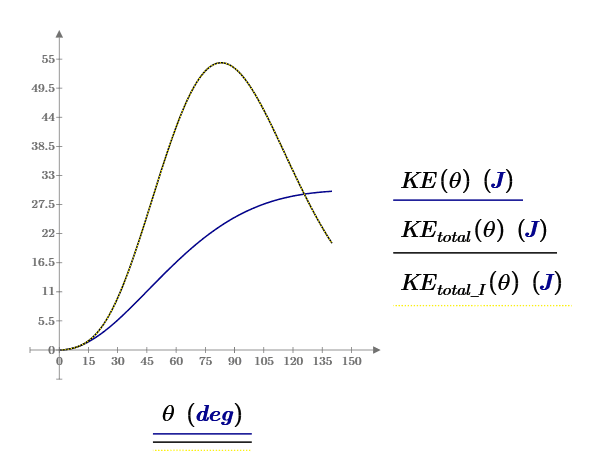

Hi again,
I have come across another hurdle.
My system has a torque about z acting on link A that drives the system, and this torque varies, it is a function of theta. I have calculated the total generalized inertia about the pivot point Z, and I have calculated the instantaneous angular acceleration for a given angle theta.
Then I have tried to calculate the angular velocity 'w' for a given angle using the following relationship:
derived from :
(integrated both sides of the second last line).
But my issue is that if I check my kinetic energy of the system with the energy input to the system, they do not match. The system has more kinetic energy than I gave it. I believe this is because I am not conserving angular momentum. I believe as my inertia starts low, the system accelerates rapidly and as the inertia increases, the system does not slow down with the way I have calculated 'w', only the instantaneous alpha is affected.
Is there another way I should be calculating velocity that will conserve momentum?
I have attached two graphs that I believe demonstrate that momentum is not being treated correctly. The larger kinetic energy is 1/2 I w^2 and the lower KE is the input energy. As you can see the inertia in this case increases significantly and this increases the KE. My system is not exactly as per the diagram, so the graphs might not match exactly if you think too hard about them, they are just there to help illustrate the point.
Thank you for any help, and sorry if this should be in the engineering section.

Mick, did you look at either of the references that I gave you? This entire problem is worked in detail in each of them.
Your equation of motion, alpha = T/I, is not correct because this is a variable inertia system (I is not constant, but varies with the angle).
Please check the references that I gave. The solution is a bit too detailed to write out here, but it is not hard to do. You should find the references available in your library or on line.
