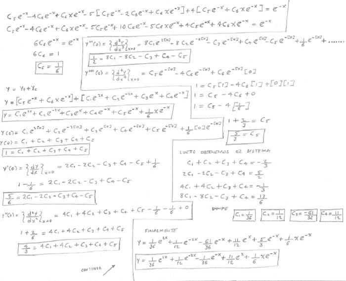

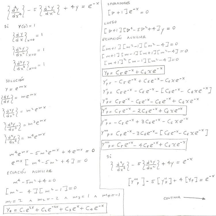

hello ... I wanted to demonstrate the solution of a differential equation, and as I do not yet know the latex language, then I take pictures of the leaves with my solutions ... the user who wants to give more solutions is well received and is welcome ...

Looks correct to me...but a question though to the forum ...in trying to solve for the particular solution, would it be ok setting ##y_p=c_5e^{-x}## rather than ##y_p=c_5e^{-x}+c_6xe^{-x}##? unless i am missing something here...
