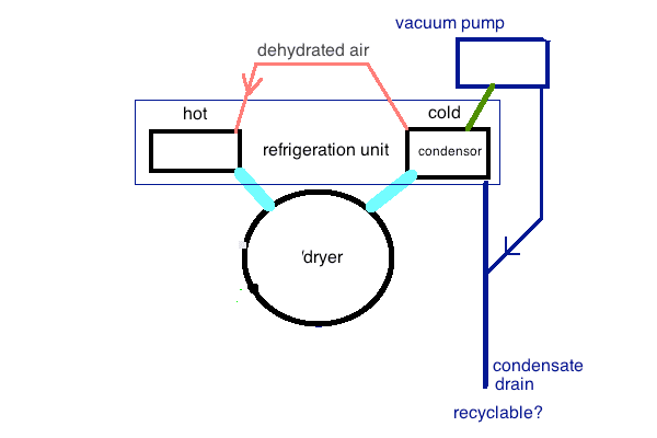

I've had the thought for years that it should be possible to dry damp clothes instantly (or almost instantly): You place them into an airtight container, then pump all the air out. In the vacuum, the boiling point of water drops to room temperature, so the water would all boil away, leaving perfectly dry clothes.
The only problem is that now the vacuum chamber is full of water vapor. If you open the door to the chamber to get your clothes out, the vapor would condense again, getting your clothes wet all over.
It's a kooky idea, but I'm just wondering if anybody has a bright idea for getting the clothes out of the vacuum chamber without water condensing on them? If the idea makes a million dollars, I'll split the royalties with you.:wink:

Could you install a condenser coil in the vacuum chamber, perhaps separated by a thick perforated metal baffle with the condenser at the opposite end. Keeping the coolant circulating through the camber totally isolated from the vacuum process, perhaps pulling the moisture away from the clothing?

I like the idea of lowering the pressure to lower the boiling point. There is a lot of low quality "waste" heat in the world which could be used for drying if the boiling temperature were reduced. It would also reduce wear on the clothes.
1/10th atmosphere seems to be about 45ºC. Using a tumbling, warmed metal cage with a cooler outside wall to precipitate the water might help.
Microwaves are certainly an option as well. I don't think enough is known about microwave absorption in ice to naively pick a frequency, but there's a good chance the waves could be tuned to go after forming ice crystals rather than liquid water. (The data I've seen vary enough that I wouldn't be confident at odd temperatures and pressures without doing further research.)
I've not worked enough with low pressures to know how expensive such a setup would be. Seals would be a problem area, but the main chamber doesn't seem like it would be that much more expensive than a traditional, metal clothes dryer.
But a high air volume, low pressure dryer could theoretically outperform traditional methods. Industrial scale machines for large hotels etc. could use a continuous rather than batch run. This would save on capital costs of linen, actual linen costs, energy costs, and labor costs.

You may put a chilled wall inside of chamber, at -50C. At 10 Pa, this value of temperature is below of the triple point of water,
so you can stop the vacuum pump and the water vapors will be collected by the chilled wall.

Curved non contact black body radiant heating panels .
Moderately powerful suck down which reduces chamber pressure to about 90% atmospheric but not to full vacuum .
Constant small inflow of atmospheric air .
Tumbling action .
Energy recovery system .
