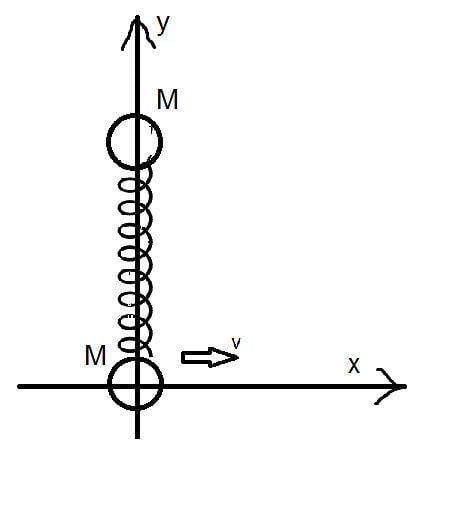

If the time is enough large, that 's right? Can you prove that by dynamical equations? I have to use this to solve another hard problem.
Two mass M are connected by spring has a stiffness k. Each body just moves on one-way. Initially, they are at ##(0,0)## and ##(0;y_0)## and the spring isn't deformed. So ##y_0=l_0## with ##l_0## is natural length of spring. Giving for body at (0;0) a velocity v. Find the equation of motion of system.

Not sure what that was in response to. For moments about instantaneous centre of rotation I said "infinitesimal", i.e. arbitrarily small.
Anyway, for this question, conservation of angular momentum would not apply. Neither would linear momentum. The masses are constrained each to move in only one dimension, so there must be external forces.
External forces have directions to the instantanerious center rotation. So angular momentum with instantanerious center rotation will not change. If the problem was written in started is right.

It is true that you find where the external forces intersect, but, as you say, that point keeps moving, and we are not dealing with an instantaneous impulse here, so it won't help.
I don't understand why you want to bother with the instantaneous centre of rotation in this problem. How about a different conservation law?

I think it very hard. Because all condition of problem suggests our to use started:
- The force of spring is the force inside.
- External forces have directions to the instantanerious center rotation.
You know the directions of the external forces, so what equations can you write for the perpendicular direction for each mass?
Oh I realize this problem. Thanks
