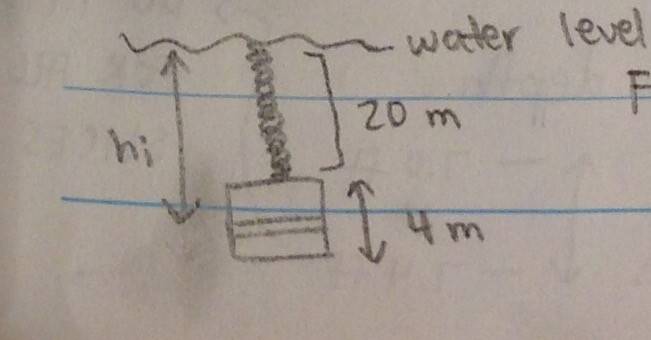

Another question... here we go...Suppose that a cubic container measuring 4 m on a side has been suspended in the ocean from a ship by a 20 m cable attached to its top. Assume that the top of the cable is exactly at water level...
(The entire question is actually quite long, and so, I'm only going to type in the part of this question that I don't get.)
... Consider the hydrostatic force on the bottom face of the container vs. that on one vertical side of the container. Which one is greater?
Can someone explain why the force on one vertical side of the container is greater than that on the bottom face only? I thought it's the other way around, since if you were to compute the force on one vertical side of the container, you'll have to integrate for pressure due to the fact that the depth varies along the vertical side, so when this "integrated" pressure is multiplied by area to get force, the value would be larger than that for just the bottom face of the container... (Random logic used here, I think.)

OK. But if we were to use slicing to get the total hydrostatic force on the vertical side and then compare that to the total hydrostatic force on the bottom face, I do get a larger value for the bottom face, which is correct, but the force on the bottom face is not exactly double that on any of the sides... :(

I was going to attach photos of my solution, but MATHHELPBOARDS said that each of my files exceeded the max size for an attachment, so I'm just going to type out what I have on paper.${Force}_{bottom}$ = ${Pressure}_{bottom}$ * ${Area}_{bottom}$
= (1000 kg*m$^3$)(9.81 m/s$^2$)(24 m)(16 m$^2$)
= 3 767 040 N
**NOTE: 1000 kg*m$^3$ is the water density for the ocean.
As for the vertical side, we must integrate to get the force...
Slice so pieces have approximately the same hydrostatic pressure. Therefore, one must slice horizontally.
${Force}_{slice}$ $\approx$ ${Pressure}_{slice}$ * Area
$\approx$ 1000(9.81)${h}_{i}$ * 4 $\Delta$h
Adding slices, ${F}_{TOTAL}$ $\approx$ $\sum_{i = 1}^{n} 1000(9.81)$${h}_{i}$ * 4 $\Delta$h
As $\Delta$h $\to$ 0,
${F}_{TOTAL}$ $\approx$ $\lim_{{\Delta h}\to{0}}$ $\sum_{i = 1}^{n}$ 1000(9.81)${h}_{i}$ * 4 $\Delta$h
$\approx$ $\int_{20}^{24} 4000g{h}_{i}\,dh$
$\approx$ 3 453 120 N

Ugh...I misread the problem, and thought the top of the cube is at the water's surface, not the top of the 20 m cable. So, if we let $c$ be the length of the cable, we find:
$$F_v=\frac{\rho x^2(2c+x)}{2}$$
$$F_h=\rho x^2(c+x)$$
So does this mean that the larger hydrostatic force isn't necessary double that of the smaller force?
Only when $c=0$ is the force on the bottom double that on one of the sides.
Yeah, OK, but does my solution make sense? I don't even know if it's right or not with these problems anymore... :(
Okay, if we plug in the given data to the formulas I posted, we get:
$$F_v=\frac{\left(9.81\frac{\text{m}}{\text{s}^2}\cdot1000\frac{\text{kg}}{\text{m}^3}\right)(4\text{ m})^2(2\cdot20+4)\text{ m}}{2}=3453120\text{ N}$$
$$F_h=\left(9.81\frac{\text{m}}{\text{s}^2}\cdot1000\frac{\text{kg}}{\text{m}^3}\right)(4\text{ m})^2(20+4)\text{ m}=3767040\text{ N}$$
Yes, our results agree. :)
