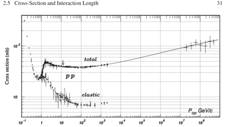

Hello. I am reading DeAngelis - Introduction to particle and astroparticle physics and I have come across a plot showing proton proton cross section vs energy. I am trying to reconcile the statement in the book that says cross section total = cross section elastic whenever there is no available energy to create new particles. Does this happen at 1 GeV on the graph? Am I to assume new additional particles are being created after a 1GeV collision?

Yes.
