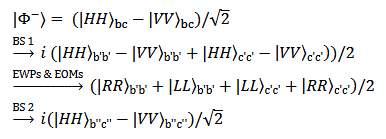

@DrChinese According to Ma:
https://arxiv.org/pdf/1203.4834
Ma said:
The two complementary measurements are realized in the following ways: The Bell-state measurement (BSM) corresponds to turning on the switchable quarter-wave plates. In this case, the phase of the interferometer is π/2 and the interferometer acts as a 50/50 beam splitter. Therefore, the two photons interfere and are projected onto a Bell state by polarization-resolving single-photon detections. The separable-state measurement (SSM) corresponds to turning off the switchable quarter-wave plates. The phase of the interferometer is 0 and the interferometer acts as a 0/100 beam splitter, i.e. a fully reflective mirror. Therefore, the two photons do not interfere and are projected onto a separable state by polarization-resolving single-photon detections. When used for a BSM, our BiSA can project onto two of the four Bell states, namely onto |Φ + 〉 23 = (|𝐻𝐻〉 23 + |𝑉𝑉〉 23)/√2 (both detectors in b’’ firing or both detectors in c’’ firing) and |Φ − 〉 23 = (|𝐻𝐻〉 23 − |𝑉𝑉〉 23)/√2 (one photon in b’’ and one in c’’ with the same polarization). When an SSM is made, we look at coincidences between b’’ and c’’ with the same polarization (as in the BSM case for |Φ − 〉 23) and the resultant projected states are |𝐻𝐻〉 23 and |𝑉𝑉〉 23.
Considering the scenarios where one photon fires b'' and one fires c'' with the same polarization. If Victor decided to carry out an SSM, this projects the photons into the state |𝐻𝐻〉 23 or |𝑉𝑉〉 23. If victor decided to carry out a BSM, this projects the photons onto the state |Φ − 〉 23 = (|𝐻𝐻〉 23 − |𝑉𝑉〉 23)/√2.
This means that if an SSM was carried out, the scenario (b'' = V and c'' = V) and the scenario (b'' = H and c'' = H) will be assigned to different partitions (|𝑉𝑉〉 23 and |𝐻𝐻〉 23 respectively). However, if a BSM was carried out, the scenario (b'' = V and c'' = V) and the scenario (b'' = H and c'' = H) will be assigned to the same partition (|Φ − 〉 23).
How would you square this with your claim that the partitions are the same even if the data is altered?
[edit] - expanded

Morbert said:
@DrChinese According to Ma: https://arxiv.org/pdf/1203.4834
Of course I agree completely with Ma et al. As I answered this question in the other thread, so I answer here.
1. Your question regarding the 2 & 3 photons (b and c detectors in the Ma paper): Is HH (swap) = HH' (no swap) and VV (swap) = VV' (no swap) ? In other words, are they measuring the same/equivalent characteristics (apples to apples)? Do the results stay the same after the beam splitter regardless of whether a swap is performed? Can we be sure a swapped HV or VH doesn't get wrongly reported as an HH or VV as a result of an hypothetical overlap effect in the beam splitter?
Well of course the answer is YES, we can be sure. It has to be, this is physically dependent on the polarization characteristics of a beam splitter - which are essentially none for our purposes. No amount of interference or interaction between 2 photons overlapping in the beam splitter is going to change H to V (or vice versa). There is no evidence otherwise, and there is no theory to support that speculative idea. It is easily testable, although I have never seen such an experiment. (Of course, there are many experiments one might perform to confirm the predictions of QM that have never been performed.)
2. Importantly: Even if there was the completely invented effect you imagine, there would be severe constraints on how it works. The constraints, in fact, would be easily discernable. i) The effect could only change the 2 photon or the 3 photon, but not both. Hopefully you can see why. Further, that specific results would necessarily require that exactly 1 photon change 50% of the time. That's to match the predictions of QM - and takes a bit of calculation to see why. Obviously, such a large and specific effect would have been noticed in the past 20 years or so.
3. Next, you ask: Are the selected [4 fold] subsets (what you also call partitions) the same? Answer is of course, NO, as the authors say in your quote. That's because the swap induces a change in the 1 & 4 pairs - they are correlated in a specific Bell state, when they weren't before. If I execute a swap, 1 & 4 will be entangled. If I don't execute a swap, they will not be entangled. When 2 & 3 are swapped as |Φ−〉 (which is indicated by the signature HH or VV result) , 1 & 4 will therefore marry up to a different correlation average (1.0 in the ideal case) than when the SSM is executed (0.0 ideal case).
So you have it backwards: 1 & 4 appear to change as a result of the swap, while the 2 & 3 signatures of HH or VV remains the same regardless of swap/no swap. The 2&3 datasets (swap/no swap) themselves are comparable, but the 4-fold results (including 1 & 4) are different - that is what the experiment was designed to demonstrate.
The [2&3] "partitions" must be considered differently than the [2&3 and 1&4] "partitions". We can't make sense trying to ask your questions and jumping from discussing one to the other. The experiment is only about 4-fold results when a single variable is changed - as happens in normal scientific experiments. We should strictly discuss their results. Which are: Swap->correlation, no swap->no correlation. You should explain this. I would assert, to the naked eye, it looks like the swap causes the correlation. In any other experiment (outside of QM), that would be the singular conclusion. Again, maybe there is another explanation...
...But there is NO evidence that overlap in a beam splitter has any material effect on the 2 & 3 polarization. If you dispute this well accepted point, please provide a reference to the contrary. Repeat: beam splitters do NOT change H polarization to V (or vice versa). And it does not matter whether there are 2 photons overlapping or not. It would be a major optical discovery to learn otherwise.
Of course, there are plenty of things that happen in a beam splitter of great interest, and which have been studied in great depth. An example is this 2015 paper by Henault which summarizes some of that. For example, a beam splitter can modify phase of a photon. However, that phase shift is always by a fixed amount (π) and does not change H to V or V to H. They also discuss HOM interference (2 entangled photons in a beam splitter), which again does not change H to V or V to H. So... there's that.
To summarize: You are speculating about a previously undiscovered quantum mechanical effect inside a beam splitter - and one that can be easily proven false.* Even in the Interpretations subforum, such nonstandard ideas must be getting close to (or over) the line.
