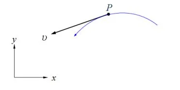

geordief said:
They are not "on" the sphere (except at one point) Are they a property of the sphere?
Go one dimension down. You often see diagrams like below, that show the velocity vector v at point P along a curved path. While those diagrams are intuitive, you have to keep in mind that position and velocity vectors are part of two different vector spaces. Also note that P and v can both can be represented intrinsically to the path by single number (1D vector) each, instead of 2D vectors of the embedding space.
The same applies one dimension up to those diagrams of tangent planes at curved surfaces.
