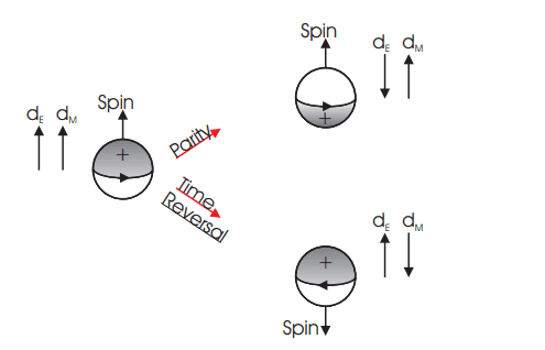

Right, I guess this is my whole point. This diagram is an example of what I'm confused about. Henley and Garcia claim that parity invariance means that an electron cannot have an electric dipole moment:
By performing a parity inversion about the midplane, we see that the parity inverted particle has an electric dipole moment oppositely directed relative to the spin of the particle, whereas the magnetic dipole moment remains parallel to the spin. Thus, if parity is conserved, the particle cannot have an electric dipole moment since you can tell the mirror picture from the original one.
But as we established, ##[P, H] = 0## does not mean that that the resulting wave function has to be physically indistinguishable (unless it's an eigenstate of P). So on what grounds are they saying that parity conservation means we shouldn't be able to distinguish the system pre and post parity transformation?

More precisely, what we established is that it has to be an eigenstate of both ##H## and ##P##, or, equivalently, it has to be an eigenstate of ##H## that is non-degenerate (which is sufficient to show that it must then also be an eigenstate of ##P##).
So now the question becomes: what kinds of states of electrons are Henley and Garcia talking about? I don't have their book so I can't check, but in Ballentine, for example, in section 18.1, he presents an argument for why a non-degenerate eigenstate of ##H## for a system with ##j## particles (he doesn't specify what kind of particle) cannot have a nonzero average electric dipole moment (i.e., a nonzero expectation value for the electric dipole moment). The argument is as follows:
First, the electric dipole moment operator is ##\mathbf{d} = \Sigma_j q_j \mathbf{Q}_j##, where ##q_j## and ##\mathbf{Q}_j## are the charge and position operator of the ##j##th particle. This operator can be shown to have odd parity, i.e, ##P \mathbf{d} P^{-1} = - \mathbf{d}##, or, equivalently, ##\mathbf{d} P = - P \mathbf{d}##. If we now consider two states, ##\psi## and ##\psi^\prime = P \psi##, we find that their expectation values for ##\mathbf{d}## are related by:
\langle \psi | \mathbf{d} | \psi \rangle = \langle \psi | P^{-1} P \mathbf{d} P^{-1} P | \psi \rangle = \langle \psi^\prime | P \mathbf{d} P^{-1} | \psi^\prime \rangle = - \langle \psi^\prime | \mathbf{d} | \psi^\prime \rangle
Then, consider a stationary state ##\psi## of ##H##, i.e., ##H \psi = E \psi##, where ##E## is a non-degenerate eigenvalue. Assume ##H## is invariant under ##P##, i.e., ##P H P^{-1} = H##, or, equivalently, ##[P, H] = 0##. Then, if ##P \psi = \psi^\prime##, we have ##H \psi^\prime = H P \psi = P H \psi = P E \psi = E P \psi = E \psi^\prime##. In other words, ##\psi^\prime## is an eigenstate of ##H## with eigenvalue ##E##.
But we specified that ##E## is non-degenerate, which means ##\psi^\prime## must be physically the same state as ##\psi##, i.e., ##\psi^\prime = c \psi##, where ##c## is some complex number. But since we also have ##\psi^\prime = P \psi##, if ##\psi^\prime## is physically the same state as ##\psi##, then ##\psi## must be an eigenstate of ##P##, which means that ##c## must be one of the eigenvalues of ##P##, i.e., ##c = \pm 1##.
Putting together all of the above, the expectation value of ##\mathbf{d}## for ##\psi## is:
\langle \psi | \mathbf{d} | \psi \rangle = - \langle \psi^\prime | \mathbf{d} | \psi\prime \rangle = - c^2 \langle \psi | \mathbf{d} | \psi \rangle = - \langle \psi | \mathbf{d} | \psi \rangle
This can only be satisfied if ##\langle \psi | \mathbf{d} | \psi \rangle = 0##.
The above argument works fine for ##j = 1##, so it is sufficient to show that a non-degenerate eigenstate of ##H## for a single electron can't have a nonzero expectation value for ##\mathbf{d}##. Notice, though, that this only works if ##\psi## is a non-degenerate eigenstate of ##H##, as Ballentine explicitly notes. He gives a counterexample for the degenerate case: the first excited state of the hydrogen atom, ##n = 2##, is fourfold degenerate, and linear combinations of the different orbital states can have a nonzero expectation value for ##\mathbf{d}##.
Ballentine also remarks right after this that a necessary condition for a state to have a nonzero expectation value for ##\mathbf{d}## is for it to be a linear combination of even and odd parity states. Notice that that is exactly the kind of state we used earlier as a counterexample for the degenerate case, and the reason Ballentine gives for why this kind of state is a counterexample is exactly the reason I gave earlier: the parity operator acts differently on the even and odd components.

PeterDonis said:
Notice, though, that this only works if ψψ\psi is a non-degenerate eigenstate of HHH, as Ballentine explicitly notes.
Ahh, okay, this makes a lot more sense to me.
PeterDonis said:
More precisely, what we established is that it has to be an eigenstate of both HHH and PPP, or, equivalently, it has to be an eigenstate of HHH that is non-degenerate
So to be physically indistinguishable, we do need it to be an eigenstate of both, as I initially thought.
