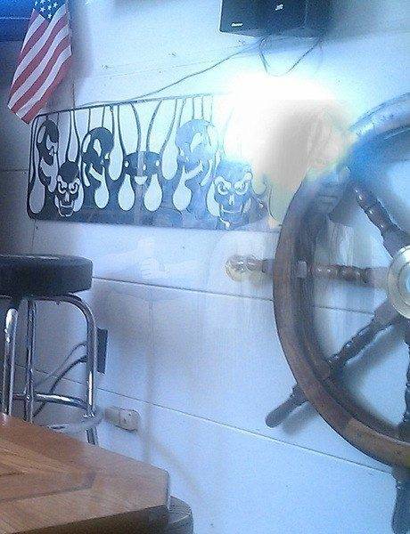

The discussion revolves around a photo claimed to show a ghost, allegedly taken with a new cell phone. The individual who took the photo insists it is real and is willing to submit the phone for testing to verify the photo's authenticity. Participants analyze the image, suggesting it may be a reflection or a trick of light rather than a ghost. Some point out features like a rectangle in the background that could indicate a doorway or window, raising questions about the photo's legitimacy. There are concerns about potential manipulation, with discussions on how digital images can be altered and the importance of examining metadata for evidence of editing. The conversation also touches on the idea of factory-level hoaxes and the possibility of software glitches. Overall, skepticism prevails, with many participants leaning towards the conclusion that the image is likely a result of digital anomalies or tricks rather than an actual ghost sighting.

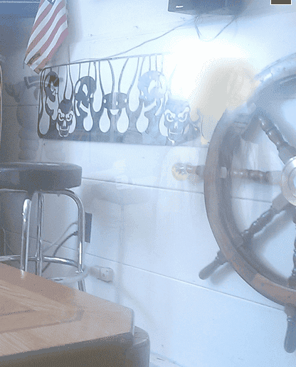

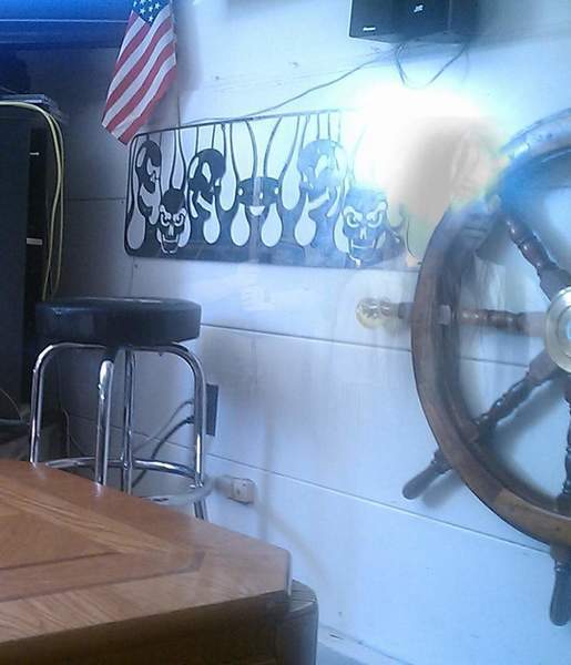

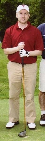

By the way, if anyone is curious, here's the process I used to make my fake, including mis-steps:
1. I browsed my photo library and found a good "ghost" candidate (attached). It is a crop of a scanned corporate golf outing photo.
2. I used the "desaturate" command to grayscale the image, because everyone knows that "ghosts" are gray (color ghosts in Betelgeuse and Ghostbusters, notwithstanding).
3. Used a basic rectangular selection tool to select, copy, and paste part of the photo and then moved it where I wanted it.
4. Used the "normal" blending mode and set the opacity to 10%. See attached result (2nd pic). The clear outline is a problem and the dark background only makes it worse
5. The "overlay" blending mode seems to provide better mixing, leaving the background color more intact - 3rd pic is in that mode, 20% opacity.
6. The borders are still very evident, especially in places where the overlay color is much darker than the original "ghost" photo background. I re-selected the area in my "ghost" photo, then applied the "feather" command, with a 50 pixel radius to create a gradient at the edges of the copied area to more smoothly blend them. See 4th pic.
7. #6 helps, but since the "feather" is created from a rectangular selection, it does not completely eliminate the outline. So next I used a freehand selection tool to grab an outline of myself a little better (and cut away the rest of the person next to me) that contains no straight lines. Then feathered that. The result is what I uploaded last night.
Note: I have Photoshop CS2, but all of that can be done with virtually any photo editing program worthy of the categorization.

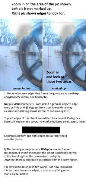

You can visually determine fake photos with the naked eye, to some extent, unless the fake is very sophisticated. This one isn't. Can you see the difference in quality of the two images? The same is apparent in your example russ_watters. The image of the girl is of a different quality to the rest of the image. You can see the difference in the amount of aliasing in the image. Notice if you zoom in curved edges in the original are blocky and staggered. You also get bleeding on these edges, along with artifacts due to compression. The edges that describe the girls face are far smoother with no bleeding. I suspect the image of the girl was taken using a traditional camera (or possibly a high-res digital camera). The rest of the picture was taken on a low quality digital camera. When you put a nice, high quality, high-res picture over a low quality picture this is what happens. Dead give-away. If you wish I can post a picture illustrating what I mean?
  • #76
I took the liberty of making a quick illustration. Unfortunately I'm using a tired old CRT monitor that is very, very dark and so I have to turn the brightness up allot. In order for me to get a good view of the photo I had to readjust it and take the brightness way down. If this image is too dark to see on your screen adjust it so that it is clear. Alternatively I can undo the adjustments I made and re-upload so that you can see the picture in its original light.
Hopefully you can see the difference in quality of the two images. It is very apparent. The girls face is smooth, crisp and clear even when magnified (of-course it still has the aliasing and bleeding, just allot less). Comparatively the rest of the picture is jagged and broken. These are clearly two pictures from different sources. Also please note it is impotant to view that illustrtion at its full size (click on it again when in imageshack). If you view it smaller the effects will be dimnished (though still possable to see).
http://a.imageshack.us/img822/5969/noghost.th.jpg

first of all...it was a digital camera
Then it's fake in another way.
second...none of my friends are looking like the couple
So?
third...if can zoom in you going to see multiple faces, big and small, that are not human-like
The brain sees a lot of things that aren't really there. We try to deliberately find recogniseable patterns. Human condition.
last...i'm a boy
Again, so?
i've asked several photographers and they could not give me an explanation of that...
don't jump with conclusions!
They can't explain after proper computer analysis? Or they can't explain it by accepting you haven't tampered with it? There's a big difference.
I see potentially four faces, but the couple are in modern dress. Of course that doesn't really mean anything (why shouldn't we have modern ghosts?) but then they're posed perfectly as if standing for a camera shot. To add to that, as I said before, this would mean the ghosts where standing on your legs. Why would they do that? What would make them think "ah, a camera randomly aimed at the floor - let's get stuck in!"?
Also, why such a random shot?
  • #83
Well it looks like a perfect example of double exposure. But then we're told it's digital and so the only way this can occur is by being edited.
I'd love to examine the original, but I somehow doubt we'd get that.
  • #84
YinepuOfSand said:
nismaratwork@ the photo is not fake you stupid if is on the camera!
We don't know it's on the camera. We don't know anything other than the picture you posted which may or may not be the original.
Cut the attitude. It looks about as fake as possible and there's nothing about it that suggests otherwise.
jarednjames@ i don't know why this random shot...the things there do not look like someone from my group...
So what if they don't look like someone from your group. I never said, nor implied they did.
It's random because of where you're aiming the camera - or did you mean to take a pic of someones crotch?
EDIT: In fact, it would be silly to use people you know to fake it. People would spot that far too easily.

is not edited...why do you people think that everything is fake?...how the **** can i do double exposure with so many figures with different sizes?...
  • #86
Because there is no evidence it is real.
There are ways of producing these effects quite easily.
The figures all look to be of the same scale to me.

I have analyzed the photo and have found what I feel is essentially conclusive evidence that the ghost part of the image is a digital artifact, not something within the body of the picture. I think most of you who are used to examining photos will be forced to agree.
Several of you have alluded to it, the first I noticed being Evo. But I feel it can be taken much further.
Note: it does not conclude the image is hoaxed - it could be an innocent superposition. But it does conclude that it is a digital (in-camera) artifact.
1] There is - not one but two edges - to the left and top of the ghost image - that are, not merely straight vertical and straight horizontal, but precisely (digitally) vertical and horizontal. Zero pixel aliasing along their lengths.
Not just almost precisely - consider: if a genuine object's edge were as little as 0.25 degrees from true, it would show up as some anti-aliasing across several of antialiasing in it. (see attached image for a sample of an object rotated a fraction of a degree).
2] The two edges are precisely 90 degrees to each other. This means, if within the image, the object is perfectly normal
to the line of sight of the camera (zero obliquity) AND that there is zero barrel distortion from the zoom factor. This simply cannot happen with a physical camera setup.
See attached graphic (here it is full size: https://www.physicsforums.com/attachment.php?attachmentid=33492&d=1301014537) but please examine the original 1600x1200 image.

The photo has no exif data. At the very least, it was edited to remove that data.
What can you tell us about the camera?

DaveC426913 said:
I have analyzed the photo and have found what I feel is essentially conclusive evidence that the ghost part of the image is a digital artifact, not something within the body of the picture...
You're a little late for that train, Dave - the last few posts are examining a new photo posted today and that conclusion about that photo was reached pages ago...
  • #93
I know. I think my evidence is more compelling - virtually conclusive. I think it overtrumps 'plausibility'-like arguments and closes the book on doubt.

russ_watters said:
Ok...it's just...while you presented it nicer by highlighting them, we discussed those lines already.
I know. I mentioned that.
But unless I missed some posts, no one took it as far as I did and quantified it. It's the difference between plausibility (which gives ghost-proponents some wiggle room) and virtually iron-clad (which reverses the onus of proof, putting ghost-proponents in the position of having to refute the analysis).
  • #98
I agree... this leaves very little room for any explanation except some kind of fraud, intentional... or incidental.
