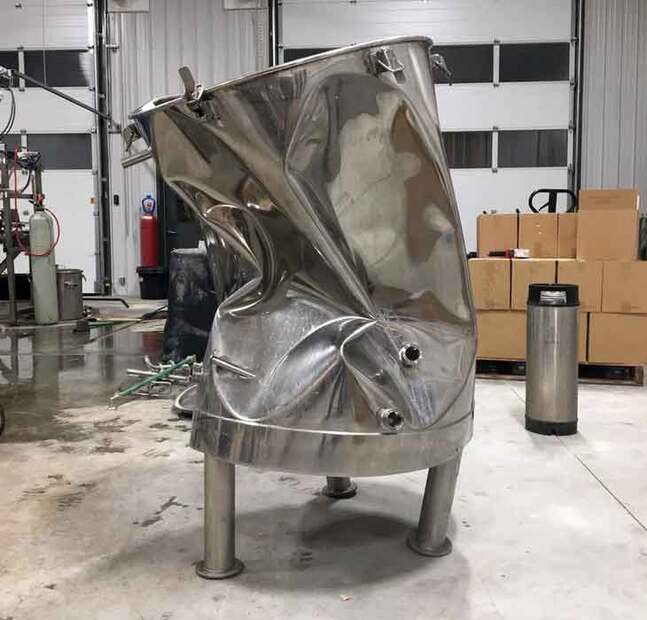

Why do you believe that "buckling from external pressure" will occur?
It should not, if that pressure is equally distributed all around the external cylinder.
I believe that resistance to buckling is proportional to t3.
A 4 mm sheet will have t3 = 64.
A 2 mm sheet will have t3 = 8.
Two x 2 mm sheets will have 2 x t3 = 16.
Well any imperfection from a perfect cylinder can cause buckling i guess. Because large tanks that is emptied without opening a vent in the top of the tank and where the tank does not have internal reinforcing rings will boucle and collapse.

Once constructed, with hoop tension in the outer layer and compression of the inner layer, a slight impact that deforms the combined layers will result in local delamination, followed by an explosive buckling of the inner layer, as the stored energy is released.
An interference fit will be insufficient for a thin sheets. The materials must be bonded with a solder or with a secure adhesive, to make a single laminated material that is resistant to delamination and will prevent the gradual entry of air or fluid between the two sheets.
