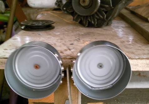

Though I did put together a perpetual motion device once to figure out why it wouldn't work.
OmCheeto said:
And as far as I can tell, I do more "hobby" experiments than anyone else here at the forum.
I don't think it's a matter of me not accepting the laws I learned in school, as much as it is me having forgotten everything.
