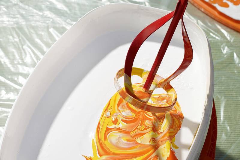

PeroK said:
I associated a setup with a real bucket and a painter's stirrer by your description, something like that:

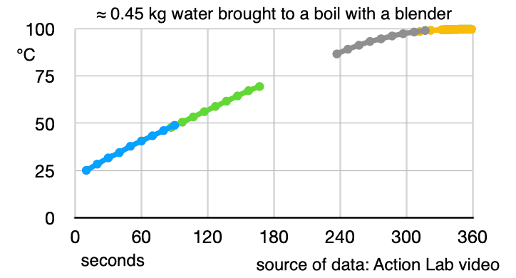

I analyzed the video from PeroK's post #9 and determined that the effective power input to the water from the blender was about 530 watts. I then googled and discovered that top athletes arms have a maximum continuous output of 30 watts. I decided that Drakkith was correct stating that it was theoretically possible but practically improbable. Can you imagine 18 Arnold Schwarzenegger sized arms trying to stir up 16 ounces of water? That would be quite the contraption to do something like that. I suppose we could give each of them one ounce containers with arm powered blenders specifically designed for the task.
Another interesting thing was that his blender heated the water about as fast as my microwave. It takes my microwave 7 minutes to bring 16 ounces of tap water to a rolling boil. In the video, the amount of water varied from between 18 to 14 ounces, so I took the average.
Much eyeballing was utilized in the creation of the graph.
