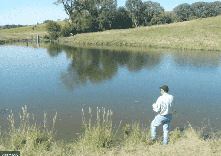

The OP needs to tell us the size of the pond. My neighbor's pond looks like this.

Pool? Lake?
sophiecentaur said:
Pool? Lake?
He made it himself using a backhoe and a bulldozer. Farm ponds are common in rural areas.
Its just a reminder that on PF, we can't assume that everyone is using the same definitions of common words.
