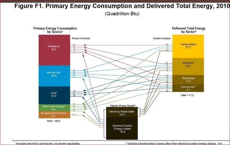

However, a more reasonable approximation can be made by using the fact that approximately 5% of the energy consumed by the car is lost as rolling friction, although rolling friction accounts for both internal friction in the wheels and friction due to the asphalt. [5] By replacing thermal efficiency in the above equation with 5%, the amount of energy released into the ground for one 20 mpg car would decrease to 0.19 MJ. This one-kilometer strip could then power at most 13 homes (32 kW) for the 20 mpg car, or 52 homes (128 kW) for an 18-wheeler. For this calculation, there is still a major assumption that all the vibrational energy of the road is captured by piezoelectric devices.
It is not clear whether the numbers currently used to quantify generating capacity are misguided or simply misreported, but under the optimistic assumptions stated above, piezoelectric devices over a one-kilometer strip of road will generate power for only about 15 homes. Unless the road carries only 5 mpg vehicles (or many more than 600 vehicles per hour), it is unlikely that anywhere near 400 kW of power can be generated from one kilometer.
