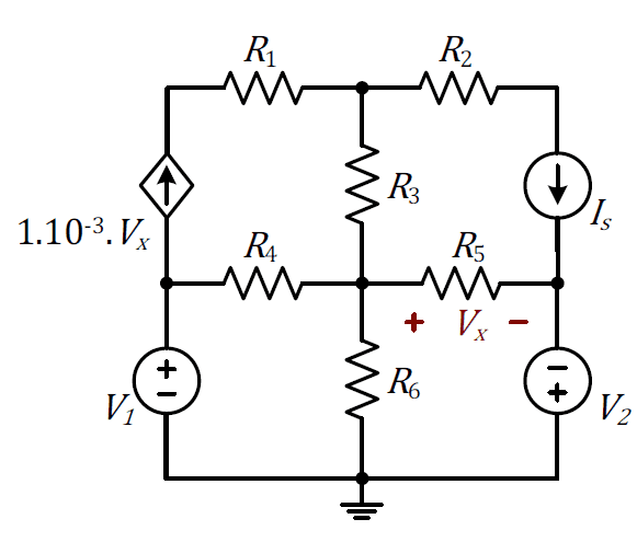

a) Determine the power
dissipated in resistor R6 using
one of the systematic methods to your
choice (nodes method or method
of the meshes). I chose mesh
Data:
Circuit data:
R1 = 2kohm; R2 = 4kohm; R3 = 2kohm;
R4 = 5kohm; R5 = 1kohm; R6 = 3kohm;
V1 = 30V; V2 = 10V; IS = 10mA
p=I^2*R
V=RI
