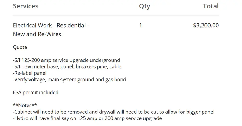

Here is the first part of the quote. The second part - what they do outside - is not germane but it's another $3Gs.

Quote specs say 125 amps upgrade to 200.

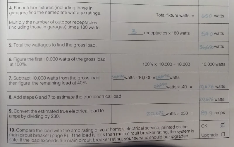

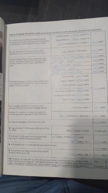

Here is a simple way to calculate service size out of a book that is probably about 20 years old. The panel in your house is at least that old. Do the math and see where you come out WITHOUT anything to be added concerning your pool. In a bit of a hurry, I'll try to get a better pic later if it's too blurry.
Alas, too blurry and low-rez, even after enhancing in Photoshop.
If you're not in a big hurry I'll get it better tonight. It should give you an idea of where you are concerning current capacity of what you currently have.
My contractor called me back. He thinks we only have 100A. I may have read the wrong imprint.
He has drawn up a new quote that involves leaving in the existing panel. It may not save a lot of money but I may be able to chip away at the total. He suggests digging my own trench would cut some costs as well.
New quote comes in at $3700. Now I can go pull my wife in off the ledge...

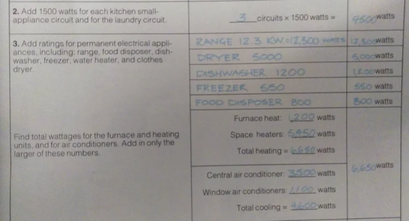

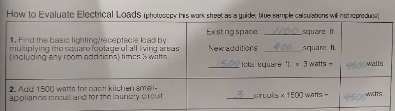

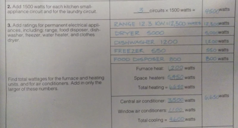

The biggest thing that will affect the size of the service is whether your heating (all, including water and clothes dryer) is gas or not. I notice you have more than half of the available space taken up by 2-pole breakers. This implies a number of 240 volt loads such as heating equipment. In about 5-6 hours when I get home I should be able to get you a better snapshot of the load estimator that I so inconsiderately posted earlier all blurry. I can zoom in on the one on my phone and see it quite clearly. I'll take pix of it in smaller chunks.
Let's try it again:
The pix are taken out of a Black and Decker Home Improvement Library book. Advanced Home Wiring. Copyright is 1992. Pretty sure I didn't buy it that long ago. I did buy it new. I think you'll be surprised at the size panel required.
Gas dryer, gas furnace, 2 electric stoves. Two family house.
