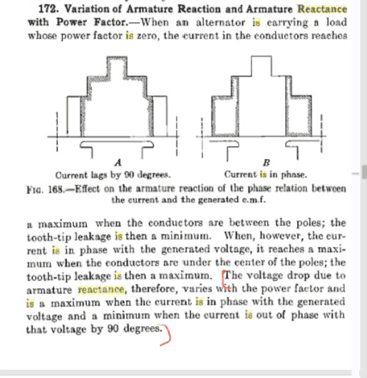

However, I recently read something new in a book and I am a bit confused. According to the discussions we had here on PF, the armature reaction drop can be modeled as a constant (internal) series reactance and the math works out fine.Here in this book, the author says the almost same thing that was discussed in the above mentioned threads, but in the last line, he says the synchronous reactance is contsant for a given field excitation.
How can changing the field excitation change the synchronous reactance? Isn't Xs a machine parameter (at rated frequecny)? Am I missing something again?
See if this makes any sense... ...
Let's add to your linked image my old single turn armature thought tool, and draw in its mmf.
I made them orange.
Armature reactance has two values does it not ? XDirect and XQuadrature ?
They differ because of the differing air gap at differing rotor angles as your excellent choice of illustration shows .
So armature reactance has an infinite number of values - XD XQ and everything in between.
Armature reaction we calculate (or measure) at rated excitation and publish it as a machine paramter.
Think about measuring that - we measure open circuit voltage then short circuit the machine and measure current.
Zsynchronous we calculate by ratio Eopen circuit/ Ishort circuit .
Now , if we repeat that test at some other value of excitation we'll get a different Eopen circuit because of the machine's saturation curve.
But Ishort circuit will still be determined by the field&armature amp-turns balance at zero flux. .(remember it's short circuited).
So Ishort circuit should be real close to NField Turns X Field Amps / NArmature Turns .
Aha ! There's the answer - we take the ratio Eopen circuit/ Ishort circuit
whose numerator includes the machine's B-H curve with its effects of saturation, and whose denominator, being measured at zero flux is oblivious to that prior saturation.
I think this author did a better job with his explanation than either i or your author...
http://people.ucalgary.ca/~aknigh/electrical_machines/synchronous/design/xs.html
Zsynchronous = f(Ifield, B-H curve) / f(Ifield , turns ratio) <<<<<< linear denominator, nonlinear numerator.
Ok, let's consider a cylindrical rotor so that Xd=Xq.
Right, and this graph describes this behaviour.
Now, as per this graph, as long as we stay in the linear region, the unsaturated synchronous reactance (considering Xd=Xq) is (almost)constant no matter how much the excitation is. Is that correct?
So when we work out numerical problems on synchronous generator in class, we "assume" linear OC characteristic curve for the generator so that Xs is constant, right?
And when my author said, " the variation of armature reaction and armature reactance with power factor is difficult to calculate", it is only because of the saturation?
Right
Yes. At least we did when i went through school.
For your smooth rotor case that's the only complication I'm aware of. Salient machine of course includes that varying air gap.
