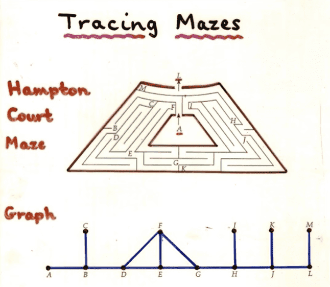

Ah, so someone has walked this road before me. This is exactly what I was envisioning:
BC is a dead-end and the graph shows it falling off the shortest path.
DEF is two paths on either side of an "island", and in the graph, it manifests as a closed loop.
It certainly is impressive how much simpler the graph is.
An adjacency matrix has a diagonal of zeros. Unless there's a self loop. A self loop results in vertex n being 1 step away from itself, which shows as a 1 in the n:n cell of the matrix.
When they're symmetrical about that diagonal axis it's because they are undirected (so steps go both ways: a>b and b>a).

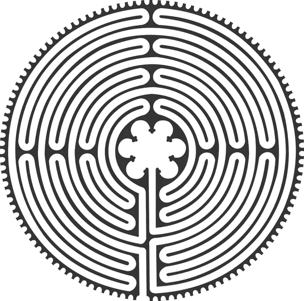

I haven't brought up labyrinths because, technically, they are trivial.
Historically, a labyrinth has a single path and no dead-ends:
