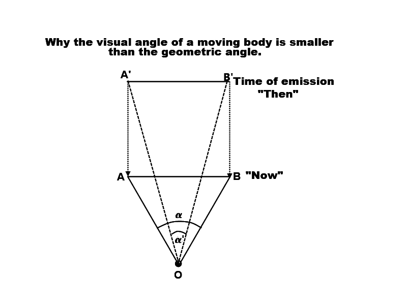

  • #67
Why the visual angle of a rapidly moving body is different from the geometric angle.
Consider a frame of reference in which we are at rest at the origin, point O.
Consider a body that is "now" at AB, rapidly approaching us at relativistic speeds. At some time in the past, A was at A' and B was at B', and the light signals from A' and B' are just "now" reaching us at the origin, point O (using the notion of simultaneity of the frame in which we are at rest, the frame in which the diagram is drawn.)
From the diagram we can see that the visual angle, ##\alpha'## of the light reaching us, which is arriving "now" and was emitted "then", is smaller than the geometric angle "now" ##\alpha##, due to the propagation delay of the light.

  • #68

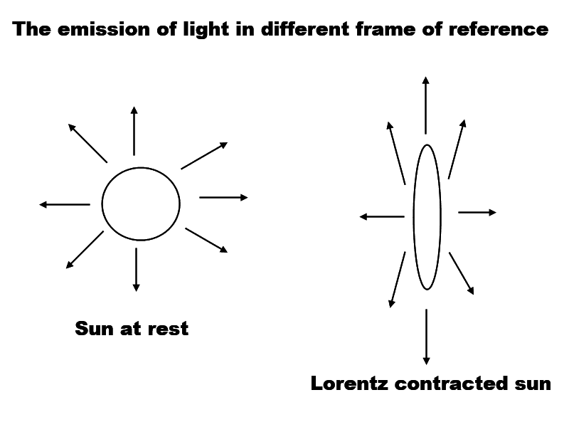

Another quick diagram - to illustrate why the emission of light, which is uniformly distributed by angle in the source frame, is NOT uniformly distributed in a frame in which the body is in motion.
We can see that the spherical sun, at rest in some frame, is not spherical in a moving frame, due to Lorentz contraction. The light emitted from the sun is also affected by the Lorentz transform, being squashed in a similar manner.

  • #70
Both of the angles are geometric. I think you meant that the geometrical angles of a pulse of light are different in terms of relatively moving systems if coordinates, which is called aberration. The "explanation" you've shown in your illustration is isomorphic (although slightly less sophisticated) to Bradley' "falling rain" explanation proposed in 1727 based on a ballistic model of light. However, to get the correct answer (relativistically) you must account for the relativity of simultaneity between the two frames (so the meaning of what you called "Now" is different depending on the frame). This is why, relativistically, there is aberration of every angle, not just of the angles of incidence of moving objects (contrary to what your pre-relativistic explanation would predict).
Another problem with your explanation is that it applies only to cases when the source and emitter have been in unaccelerated motion for the entire transit time of the light, whereas this is hardly ever true for stellar light, so it leads to the standard crackpot misunderstanding about the aberration of light from the two components of a binary star system, with different directions of motion (relative to the earth) but the same aberration.
If you work out the actual relativistic aberration, you'll find tan(a'/2) = D*tan(a/2), where "a" is the angle relative to the direction of v, and for very small angles this is a' = Da, so the solid angle for things "straight ahead" goes as D^2. This is why there is a factor of D^2 difference in the expression for spectral densities quoted on a per solid angle basis.
  • #71

  • #72
tionis said:
On this video they say that: "another property of aberration is that it preserves circles, that is - a sphere will always present a spherical outline to any observer regardless of their relative motion." Is that wrong?
The video is correct, and what pervect said is also correct. They are describing two different things. The video is talking about the visual image of a moving object, which consists of light reaching the observer's eye that has traveled different amounts of time to reach the eye (because different points on the sphere are at slightly different distances), so the visual image is not an "instantaneous" representation of the object (where "instantaneous" is defined in terms of the observer's rest frame inertial coordinates). In contrast, Pervect was describing the true shape of the sphere at a single instant (where, again, "instant" is defined in terms of the observer's rest frame coordinates). It is an interesting fact (first discussed by Terrell and Penrose back in the 1950's) that although a spherical object is fore-shortened into an ellipsoid in terms of relatively moving coordinates, the optical image at any point always remains circular.
