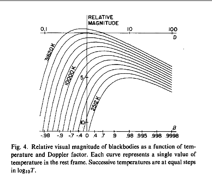

  • #60
pervect said:
Hmmm- well, doing a series expansion, I'm currently disagreeing with Kip :-(. A series expansion indicates that at the limit as ##\nu## goes to zero, the blackbody radiation goes up quadratically, and the factor that fights it, 1/z, is only linear.
As our speed toward the Sun increases, the visible light comes from the lower frequency range of the Sun's spectrum (Doppler shifted up to the visible frequency range). Remember that the energy of a pulse of light under a Lorentz transformation increases in exactly the same ratio as the frequency. So, for example, when our speed toward the Sun doubles the frequencies (i.e., when we are seeing light emitted by the Sun at half the visible frequencies), it will also be doubling the energies. However, at half the frequency, the spectral energy is extremely low, so doubling it doesn't make it very big. The blackbody spectrum eventually drops exponentially, and this drop prevails over the Doppler energy increase. Remember that as the temperature of a blackbody increases (as we approach the Sun at higher and higher speed), the peak frequency of the spectrum increases, and it will eventually pass out of the visible range. So instead of seeing the light, we'll just be getting fried with x-rays, etc.
By the way, this is more or less consistent with what is described in the FAQ article cited by the OP. That article talks about moving at high speed toward the Orion belt, and how the appearance of two of the stars would change: "The red Betelgeuse gets its large infrared spectral energy distribution shifted into the visible region, while the blue Rigel gets its spectral energy distribution shifted out to UV and x-ray wavelengths until it fades away." Of course, if we keep increasing the speed, Betelgeuse will fade away too, i.e., it will be shifted up into the x-ray region, not visible to the human eye. I think that article uses some confusing words, though, when it earlier says regarding the Doppler effect: "This results in higher flux intensity, and causes stars in front to get brighter, and from rear to get fainter." The words brighter and fainter can be misleading, because they tend to connote visibility, but really what they mean there is that the overall energy flux increases. This increase causes it to pass out of the visible range, so it gets fainter (in the visible sense) as it gets brighter (in the total energy sense).

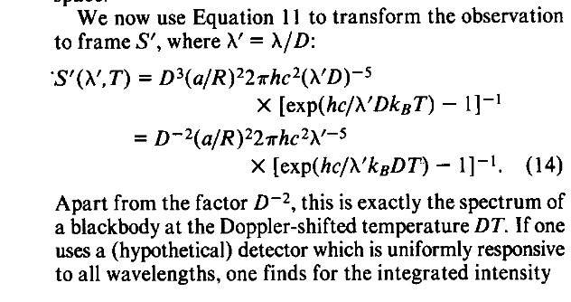

  • #64
The problem of the sun's appearance is a different (and much simpler) problem than the CMB background. The stress-energy tensor is different, too. I'm not sure if you ever looked at the thread I referenced previously, https://www.physicsforums.com/showthread.php?t=681172
Using standard t,x,y,z coordiates (don't need to use spherical coordinates, it just makes life difficult) we get the stress energy tensor for the case of interest , a "null dust" of a beam of light headed for us.
T^{ab} = \left[ \begin{array}{cc}<br /> E &amp; E &amp; 0 &amp; 0\\<br /> E &amp; E &amp; 0 &amp; 0\\<br /> 0 &amp; 0 &amp; 0 &amp; 0\\<br /> 0 &amp; 0 &amp; 0 &amp; 0\\<br /> \end{array} \right]<br />
For the CMB, you'll get something, different - the stress energy tensor of a perectg fluid, with rho = 3P. Letting rho = E, we would write:
T^{ab} = \left[ \begin{array}{cc}<br /> E &amp; 0 &amp; 0 &amp; 0\\<br /> 0 &amp; E/3 &amp; 0 &amp; 0\\<br /> 0 &amp; 0 &amp; E/3 &amp; 0\\<br /> 0 &amp; 0 &amp; 0 &amp; E/3\\<br /> \end{array} \right]<br />
Relativisitic visualization papers, such as http://arxiv.org/pdf/physics/0701200v1.pdf, describe what happens to intensity - but there is a referenced paper that's fairly easy to find, and even better!In search of the ’’starbow’’: The appearance of the starfield from a relativistic spaceship
John M. McKinley and Paul Doherty
one link is:
http://cartan.e-moka.net/content/download/248/1479/file/Astronave relativistica.pdf
Equations 10 and 11, and the associated discussion, gives what I derived in terms of the stress-energy tensor and get the same result for I.
Equation 21, in particular, gives the difference in magnitude of a star due to the motion, weighted for the approximate optical sensitivity of the human eye.
log_{10} W = 10400 K (1/T - 1/DT) - log_{10} D
D being the doppler factor ##\gamma(1+\beta \cos \theta)##
There are also some plots of particular stars of certain temperatures, given in fig 4.
An inspection of eq 21 and inspection of fig 4, and taking the limit as D goes to infinity seems to suggest that Kip was right (not too surprising), though I don't quite see yet where I went wrong.
You can clearly see in fig 4 the intensity dropping as D increases, though the drop is hardly dramatic.
  • #65

I don't think I can do the paper justice in a post, but I can provide a quick summary:
The total photon arrival from the source, integrated over the entire view, scales as r. So the photon arrival rate increases if you're moving towards the object.
You seem to have missed a square root in your presentation of r, I'll assume it's just a typo unless otherwise argued about.See http://en.wikipedia.org/wiki/Relativistic_Doppler_effect for example, for the derivation of r Just In Case.The total energy delivered scales as r^2, because ##E = h \nu## and ##\nu## gets doppler shifted. The usual defintion of intensity is via delivered energy, so the intensity scales as r^2.
Relativistic aberation makes the angle subtended by the object smaller - this causes the object's apparent area to shrink by a factor of r^2. This would make the surface brightness scale as r^4 (the same energy is delivered in a smaller area). But if you are far enough away so that the object is smaller than the optical resolution of the telescope that you look at it through, this effect won't matter. YOu'll be limited by your optics, and you'll only see a r^2 increase.
Usually, stars don't show a disk , the telescope can't resolve the surface, and we talk about the "stellar magnitude" based on the total energy received, the entire visual field maps to what's effectively a point. So that's my starting assumption. With this assumptoin we get a r^2 brightness enhancent - and a doppler shift.
The authors actually work out the received brightness in the human visual range, by using a crude model of the eye's black and white frequency response.
I'll upload a few screenshot, which I think constitutes "fair use" for educational purposes, so you can at least get some information.
One post graphs their results.
Doppler factors > 1 represent motion towards the star. You can see that eventually the brightness starts to decline.
The other screen snapshot represents the equation for the unweighted spectrum S(r). You multiply this by your "response function", to filter out invisible frequencies, and that integral gives your brightness. The authors used an gaussian weighting function to represent the sensitivity of the human eye, rather than a crude square step function (which has a value of 1 if the frequency is visual and 0 if it isn't).
But I don't feel up to presenting it at the level of detail that includes their approximate visual weighting function specifically, you'll need to track down the original paper for that.
You might be wondering why the factor in front of the integral is r^-2, if the intensity scales as r^2. If you perform the integral though (the paper does it), you'll see that the end result DOES scale as r^2.
WHile you can see that the authors integrated in terms of wavelength rather than frequency, it appears that my earlier mistake was a failure to scale ##d\nu## properly under the transform. I scaled what multiplied it properly, but not ##d\nu## itself. The paper doesn't use the same approach, they use ##\lambda## instead.
