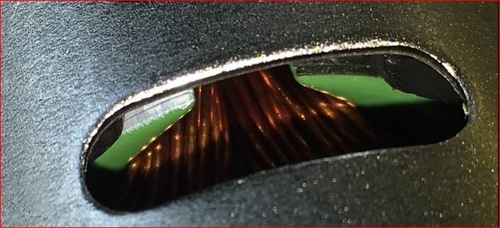

I tried different screwdrivers but I cannot open the motor. Know what kind of screw driver I need to do that? The only photos I can get right now are posted as following.

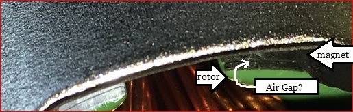

Does that inside part with the winding rotate, or is it part of the frame as it looks ?
Sure looks like a field winding. The wires look big enough to be a series field but i have no idea of scale. Can you estimate a gauge?

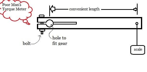

Can you dream up a way to measure its torque - drill a hole in a wood scrap and affix to shaft, then with a fish scale measure torque?
A plot of locked rotor torque vs current will be linear for permanent magnet, and a square relation for series wound.

When I rotated the motor shaft by hand, the inside part with the winding rotated as well. It was not a smooth turn. I felt like there were six pauses as I turned the shaft to its original orientation. To characterize the motor, is this way of measuring the torque ok?
Likes jim hardy
That's Good, means they're not the field .
Here's what i think I'm seeing, perhaps you can feel if the "magnet" attracts a small screwdriver tip.
Indeed that's the exact principle.
Vise Grips - handy as Duct Tape , aren't they ?
Can you control current through it somehow? Maybe a car headlight in series?
Plot torque versus three different currents and you'll know if it's linear.

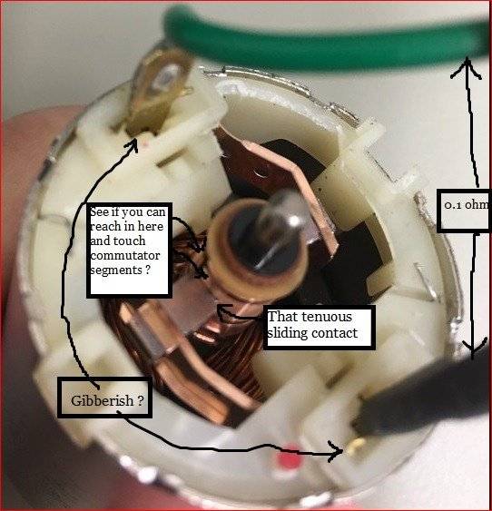

It is not a stepper motor but a DC motor for sure. Yes, only two wires coming out from the motor. I asked the company to confirm if it is permanent magnet. We will see.
Supposing that it is, all I need to do is to measure the torque (using the method in the YouTube video I linked above) and the current. Then Torque/current to obtain the Torque Constant Kt. Am I correct?
Could you please check my setup for measuring the current?
https://bbqbbq.smugmug.com/Motor/i-zKbVVGf/A
Looks right . Be Aware though it'll surprise you with its high starting current so you want a source of less than motor's rated voltage.
if it's a one amp motor it might draw ten amps with normal voltage and its rotor locked by the torque measuring device.
Furthermore at that high amperage, internal flux will get pushed out of its intended shape by something called "armature reaction" so you'll get a low number for Kt.
Armature Reaction is just the magnetic field from armature current interfering with the one from the field magnet. It pushes the field off-axis. It's a necessary evil in DC motors but at normal current levels it's not much of an issue.​
Some way to limit current to about normal running amps will help you both not blow the fuse in your ammeter AND get a good Kt measurement .
Maybe a car headlight wired in series, or use a supply that's only capable of whatever your motor should draw.

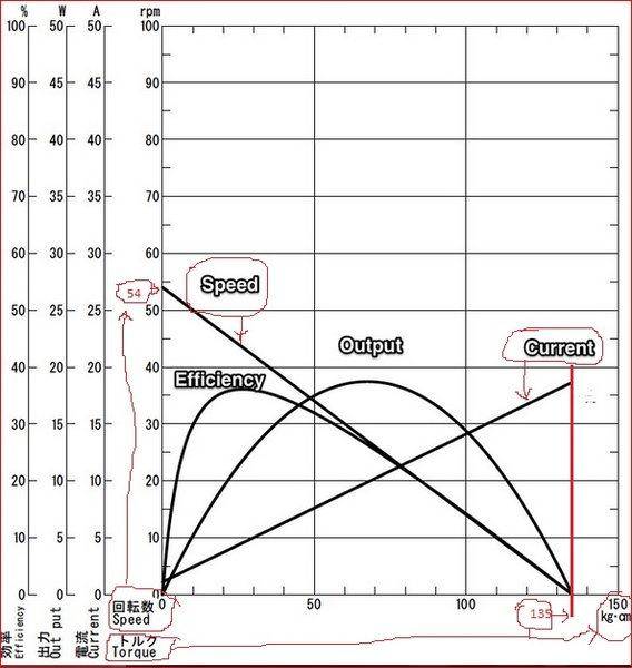

Thanks old jim. From what I gathered from the company, at the recommended voltage of 7V, the no load current is 1.2A and the lock current is 19A. The motor has a gearhead pre-installed. Not sure if the data were obtained with or without the gearhead. Probably no because it is "no load" current? My amp meter can take a max of 20A. Do you think the setup should be fine as is without extra component? At what voltage do you recommend me to do the experiment under? Note that I plan to drive the motor at about 12V in my application. (I have tried it before. Motor could survive without problem.) I don't have a car so no headlight nor car battery charger. What other component do you recommend?
Due to the way I measure the torque using the method presented in the youtube video, I should have the gearhead connected to the motor shaft. In this case, even there is nothing connected to the shaft coming out from the gearhead, the current is not a no load current due to the gears. So, if I model the motor using the method presented in the following video, all the parameters (resistance, inductance, back EMF constant, Torque constant, Voltage caused by back EMF, speed, inertia of the motor system) should be measured with the gearhead installed. I will not need to multiply the simulated torque result by the gear ratio. I also do not need to divide the speed by the gear ratio as all the parameters are measured with the gearhead on. In other words, I model the motor with the gearhead on all the time rather than model the motor without the gearhead and then try to adjust the resulting simulated torque and speed. Am I right?

Hello all, I did some measurement of the resistance using a better meter. Here is a photo of the motor:
Is it permanent magnet? The company told me that there is no information on this.
https://bbqbbq.smugmug.com/Motor/i-kCbqzvx/A
1. There are two wires coming out from the DC motor. When I connected the end of the two wires to the probes, I got 0.1 Ohm.
2. When I connected the probes to the two terminals that the two wires are connecting to the two metals coming out of the motor, the values and unit kept changing like cray. Sometimes KOhm, sometimes Ohm. Sometimes O.LMOhm.
So, what is the internal resistance of the motor?
  • #33
My guess is you're shaking the brushes when you push on the metal tab that holds them and losing that tenuous sliding contact.
Try to read between commutator segments
then from ach commutator segment to the wire of the brush touching that segment. Wiggling the shaft might help the reading settle down. Take the lowest stable reading..
From the readings you report , looks like less than 0.1 ohm.
How about if you search for a datasheet on that motor , using its model number ? Surely it has one.
