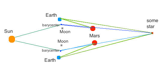

Interesting question.
Someone answering questions at NASA, when asked this said; "I don't know." [ref]
The answerer also states; "Of course, the motion of the Moon and the Earth and is really a three-body problem, also involving the Sun. It is extremely complicated: low-precision equations for describing the motion have about 30 coefficients" {bolding theirs}
Off the top of my head, I would have guessed it wouldn't be that complicated. But that's probably because I have no idea what is involved in solving a three-body problem.
Anyways, I think it would be an interesting maths problem.
Numbers I've collected so far:
The Earth-Moon barycenter is (supposedly) 4.671 million meters from earth’s center​
Earth's radius is 6.378 million meters​
Initial doodle:
And can I measure that with my 76mm reflecting telescope?
Bandersnatch said:
I did refer to ephemerides, so additional parallax of solar system objects over half a month of orbit.
Would that be measurable? Actually, the shift in Earth's position is not that much less than its diameter so maybe not so daft after all. A few thousand km relative to a distance of a few hundred million km. That's around 10-5 radians which is no problem for astronomers. Edit: well, errr measuring stellar distances in parsecs relies on the full AU.
But I see @OmCheeto has beaten me to it and Mars would be the obvious choice.
