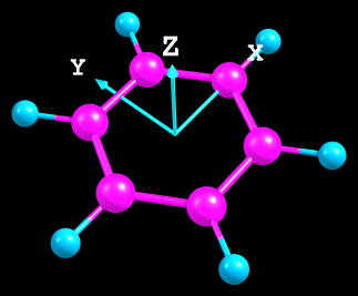

Maybe I will be able understand this using the example of calculating the moments of inertia of a molecule:
Here, firstly a symmetric 3*3 matrix is initially calculated with elements like
$$ \sum_{n} m_n y_n^2 z_n^2 $$
Then this matrix is diagonalized; i.e., maybe this matrix is simply rotated by multiplying by a 3*3 rotation matrix? And the rotation matrix is determined by the x,y,z vectors at the image.
