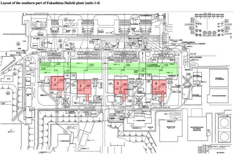

From one of the site radiation maps, I have assembled the layers beneath, i.e. the plant layout map, at:
http://gyldengrisgaard.dk/fuku_docs/plant/
Using this map, I think I can now point to the position of the two common control rooms, for unit 1+2, and unit 3+4 respectively. (Not unexpectedly, I find them spanning across the junction walls between the matching turbine buildings.)
Nice map have you got the complete map ? or just the extract you givenT/B turbine building
R/B reactor building
If C/B = control building then there is no common control room for unit 3 and 4 they are just next to each other
remember unit 4 was build after unit 3 and there would be no way that the adjoining walls or even a door be knocked into a working control room.
[PLAIN]http://k.min.us/infM52.JPG
This map shows only the coast-near southern half of of the plant. The inland areas would be on other maps, and so too would the northern part of the plant, where unit 5 and 6 are situated, but of that I have only a few useless blurry fragments.
<..>C/B = control building then there is no common control room for unit 3 and 4 they are just next to each other<..>
That's right, on the drawing, they are. So, to produce the common control rooms they just had to remove a few walls. :-)

MadderDoc said:
I have updated the page at http://gyldengrisgaard.dk/fuku_docs/plant/
It now includes maps of the northern as well as of the southern part of the Daiichi plant.
For those others who, like me, may be somewhat perceptually impaired (and not red-green color blind), here are the roof lines of the reactor buildings and turbine buildings . . .
Cheers, that's much clearer!
