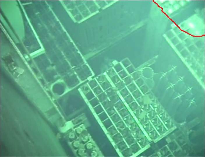

Astronuc said:
WNN - Most fuel in Fukushima 4 pool undamaged
http://www.world-nuclear-news.org/RS-Most_fuel_in_Fukushima_4_pool_undamaged-1404117.html
14 April 2011
Which, perhaps surprisingly, is consistent with the imagery, IMO.
BTW, the detailed technical drawing of the reactor building referenced just above doesn't fit the images of Unit's 3, 4. The Elevator is in the wrong location (west side, north end of the structure instead of the west side, south end of the structure.
I just love to color by number. The green overlay is the elevator shaft and access tunnel for the fuel casks. Shouldn't it be adjacent to the SFP, not the equipment pool?
Am I missing something -- is there another elevator shown and the shaft for the fuel cask transfer is not shown?
Ah Ha! Yes, The elevator shown is not the fuel cask shaft. My mistake. Hmmmmm. . .
