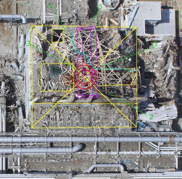

  • #4,241
TCups said:
The explosion rips off the roof from the southeast corner, The expanding gas from the explosion continues to lift the roof slab off of the girders and billow it like a sail full of air, the weight of the what is left of the roof slab is borne by the north wall of the building. It begins to fall back into the building, dragging part of the north wall inward and downward (D)
Makes me go mmm.
looking at your figure D, I understand that you think that falling back , the former north edge of roof tar slided in the building, that the sail broke and while some of the roor tar had cut and slide the rest broke and went away some how.
Most of the roof tar is in my opinion between the turbine building and the east wall.
but above the line o breakage of the sail of the stabbing tar is not consistant with what I'm seeing: the rising edge sticking out is too perfect , rectiline; for me it is the former northern edge of the building roof tar; and if so .. The bending does not fit your theories as I understood it.
if anything I'll would rather think for now that the bended slided in tar is a consequence of the roof giving down and in.
Maybe someone with a camera or audio recording equipment captured the sound but not the explosion, maybe at a different location, and the two sources were thrown together.
In deed, as for the rest my opinion stand

  • #4,246
rowmag said:
rowmag said:
From the coloring and shape, I am beginning to suspect that it is concrete wall panel from #4's own wall, that somehow got blown upwards to land on its own roof.
Tcups said:
No, the simplest explanation is the correct one. It is a piece of the roof[...]
Hmm, you're right! The corrugation pattern on the underside is visible in the following photo from houseoffoust.com:
(img removed from quote)
Another beautiful theory slain by ugly facts.
Rowmag and Tcups, can I please take a moment to say THANK YOU! Thank you for these two absolutely pure rational logical conclusions. This thread is becoming so wildly speculative, I am almost amazed people haven't come out and said these explosions were an inside job...

RE: THE EXPLOSIONS AND PATTERN OF DAMAGE AT BLDG 3 & 4 -- SIMILARITIES AND DIFFERNECES
@Fred:
M. Bachmeir did extensive analysis of the sound frequencies and concluded that Bang 1 and Bang 2 were similar and were explosions and that Bang 3 was fundamentally different from the first two, as I recall. Maybe he would comment again about the possibility of one of the audible bangs being a mechanical transient from a large falling object.
Ya, that was in the working notes/speculation I forwarded to you TCups. The problem is I can't say for certain from the data that the third explosion is wholly different from the previous two, because I was not able to eliminate the possibility that some post processing (normalization, volume adjustment etc.) had been applied to the sound track.
The best evidence for that is in the stretched and pitch adjusted remake (4 x longer, original frequency 592.593 Hz. - 705.882Hz). Listening to that playback is very revealing. Echos from each explosion (between the explosions). Five distinct sound events. The second explosive sound hit the highest peak energies, but the third had greater energy output overall.
Note: the two sound events at the beginning and end both resemble steam release.
If the third sound is the collapse of the FHM into the SFP, that would explain the last sound (superheated... rapid boiling/steam) triggered when the FHM made contact with the SFP.
If anyone knows where I can upload the modified (stretched) audio file, please let me know.

Contrary to previous opinions, it would not be that easy to fake the audio for the video in question, not with the kind of visual synchronization I found.
Note: if the audio was a fake, it would have been the same length as the video... all part of post processing... *video* 13.25 sec. approx. *audio* 12.77 sec. ?
