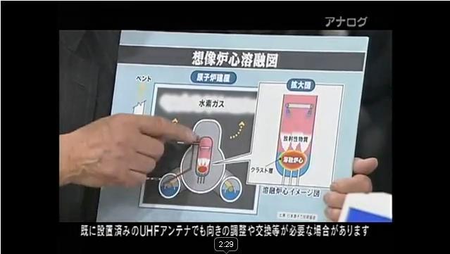

By way of example, here is why I take everything released by NHK, TEPCO, and the Japanese government with a large grain of salt.
http://www3.nhk.or.jp/daily/english/24_12.html
If you believe that video, then you also believe the SFP at Unit 4 is on the North side of the building. We know that to be false.

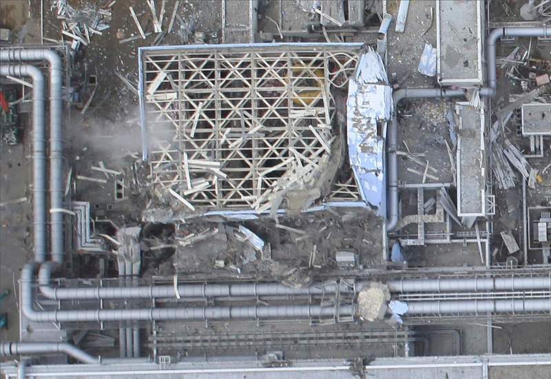

Well, after SFP with no other containment than water at the top floor just above the reactors, i discover that info: ONE control room for TWO reactors!
Great stuff from safety standpoint, really, in my own opinion.

Just a precision concerning the highly contaminated debris found and measured: that's the first time they talk aout one clearly measured but it's not the first time the presence of highly contaminated debris scattered around is revealed, that was said in one of the articles i cited on the "more political thread":
http://english.kyodonews.jp/news/2011/03/82005.html
From one worker there:
Within the plant's premises, rubble with highly radioactive materials was scattered after hydrogen explosions at reactor building in the days after the quake. ''If they are removed soon by heavy machinery, work will be a lot easier but the operator (of the machines) will inevitably be exposed to radiation,'' the man said.
Some more on this, just released, with a Tepco map of various debris on site:
http://www3.nhk.or.jp/daily/english/24_08.html
VERY UNFORTUNATELY, the maps is quickly shown and i didn't find this map on Tepco site (until now)...
Come on.. this had nothing to do with Tepco or JapGov but everything to do with media/press/ CGI

Some more information on the debris map, confirming that the reactor 3 area and the area close to the main building office are still (like the beginning) the worst ones from radioactive standpoint:
http://www3.nhk.or.jp/daily/english/24_17.html
