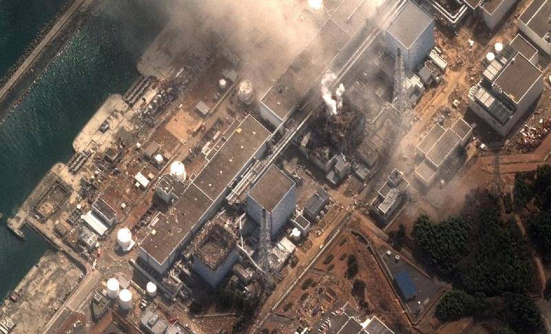

A very decent satellite photo from Geoeye, from April 12th, can be seen at:
http://geoeyemediaportal.s3.amazonaws.com/assets/images/gallery/ge1/hires/fukushima_daiichi_okuma_japan_04_12_11.jpg
Among other changes compared to earlier photos, one is struck by the green coloration of those areas which had already been subjected to antidust sprayings by April 12th.
(Would like to see how much greener Daiichi has become now, 14 days later on. After finishing those slopes at unit 2 and 3, 4, they did sizeable areas at the Centralized Radwaste treatment facility, and more recently they did large tracts over at unit 5. Spraying is now being done at the seaside of unit 1 to 4, by, quote Tepco press release, an 'unmanned crawler dump truck in full swing'. Would like to see that too.)

I found and posted a link to a quite decent, and rather more recent (mid April) satellite photo. If you like I haven't seen it before it might still your craving. For a little while :-)
