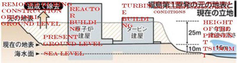

Danuta said:
It was more like a problem waiting for a disaster, than a disaster that generated the problem. "Sitting duck" comes to mind, especially when thinking in terms of recorded seismic activity and tsunami maximums.
Very much agree. The site selection and setup was arguably criminally negligent.
So no brief for TEPCOs management or their government supervisors.
However, the workers and contractors on the site, plus their line managers, who are busting their hump in an extraordinarily bad situation, deserve all the support we can give them. Their cautious approach may be mistaken, the steaming spent fuel pools may poison so much more of Japan that the leadership insists on a quicker fix, but given the flooding in the plant, nobody, not KHG, not Sandia, not anybody has appropriate waterproof robotic tools ready to go. The TEPCO crews are on their own.
"Criminally negligent"? Talk about over the top, sheesh.
