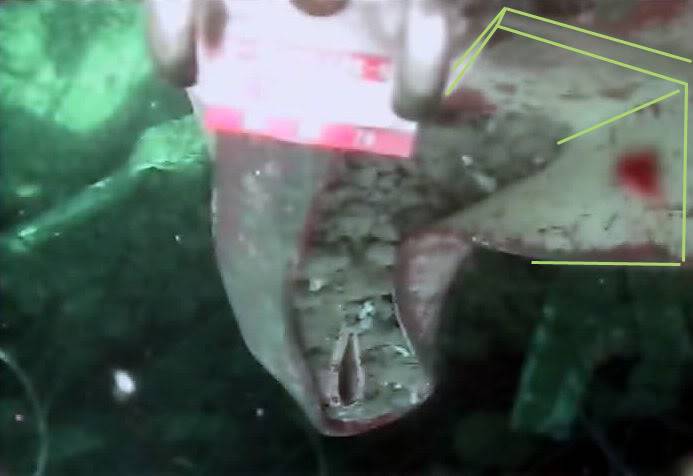

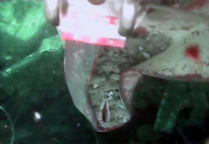

AntonL said:
I took another frame of the TBS/JNN feed and drew some [black] lines
looks OK to me
What we see here are the West and South faces of building #4. Check the close-up pictures:
http://www.ic.unicamp.br/~stolfi/EXPORT/projects/fukushima/povray/blueprint/foto/drone/hcrop/reactor4-E-3.png
The North face was quite deformed by the explosion, the Northwest corner is quite deformed and from a distance it will seem to be tilted.
Moreover the camera does seem to be slightly tilted. Here in green are my guesses as to the true vertical and horizontal lines (below left). Also note that the camera sems to be quite a bit higher then the buildings, so the top part of unit 4's outline is the top of the West wall on the left, and of the East (not South) wall on the right. Both slant down to the right in the image, due to the camera's tilt added to the prespective effect.
Note that the top edge of the North wall and the top of the East wall near Northeast corner are not visible because they are hidden by a large piece of dark gray debris, that sticks out of the roof and blends with the sky in the grabbed frame. I have drawn in pink (below right) what would have been the outline of the building before the explosion.
[PLAIN]http://www.ic.unicamp.br/~stolfi/EXPORT/projects/fukushima/povray/blueprint/foto/misc/inqMBW-e.jpg[PLAIN]http://www.ic.unicamp.br/~stolfi/EXPORT/projects/fukushima/povray/blueprint/foto/misc/inqMBW-f.jpg
