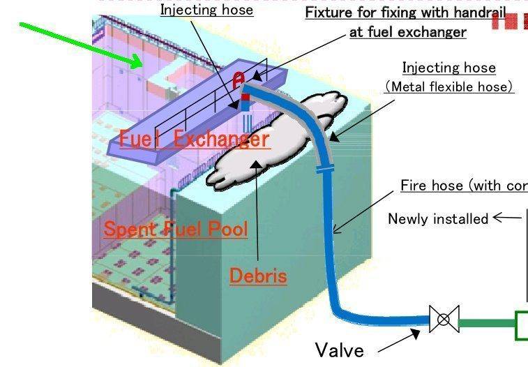

if tepco would not have considered the possibility of criticality, why would they have added boron to the cooling water?
PF quidelines: 'Personal theories posted elsewhere will be deleted'
if this guideline would be applied consequently, this thread would be dead as a dodo^^
just a personal statement: i love wild speculations. but i hate it, when they are not based on evidence and/or they are defended beyond a reasonable point.
EDIT: i was not sure if 'defended beyond a reasonable point' is correct english, so i googled it - the only hit was my post *3 minutes after posting*. google must have a high opinion of this forum^^
