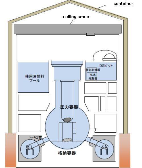

MiceAndMen said:
I don't see a drawing in there labeled "8-1" but it sounds like you're talking about page 18. The drawing that shows vents directly from the drywell to the refueling floor originated with the Areva presentation that came out weeks ago. See page 20
http://www.fairewinds.com/sites/default/files/AREVA%20Fukushima.pdf
The AREVA presentation has gotten a lot of attention here and elsewhere (mostly elsewhere) but that drawing continually escapes criticism for some reason.
I double checked, it is still page 20 of 30 as my Foxit .pdf Reader produces it. Labeled 'Figure 8-1 Reactor Well Seals'
I take it, above the drywell cap, air is able to move freely from the vents shown.
The plant lacked a way to deliver coolant and the SFPs blew up and the reactor meltdowns are just collateral damage makes no sense esp. concerning Unit 4.
http://tec-sim.de/images/stories/fusfpfail.pdf"
The "Presentation" content regarding siphoning from the spent fuel pools seems like new and potentially important information. I don't think this topic or possibility has been previously considered or discussed in this thread, has it?
