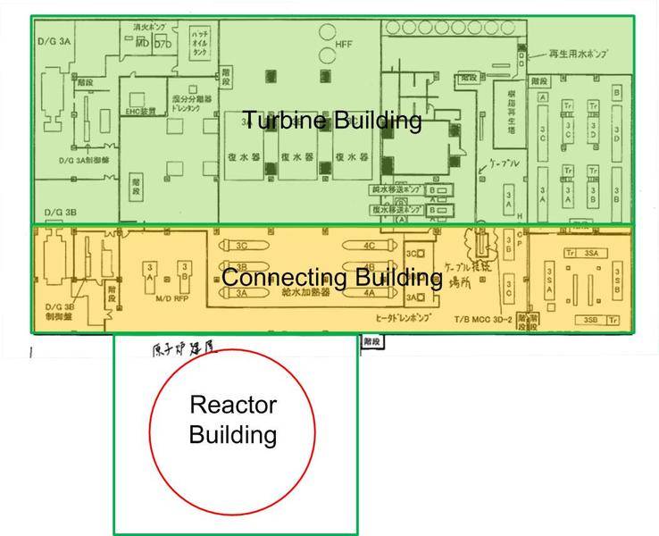

Detailed ground level radioactivity readings (I do not know where this picture comes from nor its reliability, but it appears to be genuine):
| http://static.ow.ly/photos/original/9ooW.jpg
The highest readings are just to the west and north of reactor 3. These reading may be consistent with the French agency's conclusion (and, I believe, an early conjecture here in this thread) that the protection shield over the reactor has disappeared. Gamma ray radiation could then be reflected back down around the reactor building by the remaining beams and detritus (as well as simply backscattered by the atmosphere).

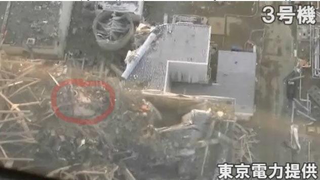

Maybe not! Sometimes if you just keep looking, you will see the obvious. . .
1) the north wall did not collapse inward. The vertical and diagonal overlay pattern of the roof beams is the normal structure of the roof beams. Compare the intact beam structure of Unit 4 to the undamaged remaining portions of Unit 3.
2) The central portion of Unit 3's roof beams are intact, and, I believe, collapsed downward after the initial blast blew out the south wall and the crane blew back through the north wall. This hint actually came from the French-annotated picture, above, fuzefiz's post. The heavy overhead crane structure was blasted out the back wall, falling on and heavily damaging a portion of the building below (arrow)
3) Implication: the plug is likely still atop the core containment, roughly in the center third of the damaged Unit 3 bldg. The blast came outward through the SFP gate, breeching the side of the containment, then, upward, out of the SFP (circle).
4) The sidewise blast peeled back a part of the corner of Unit 4.

It looks like I just spent about 90 minutes reviewing just under 10 minutes of video, and capturing 75 still frames from the video.
I challenge everyone here, now knowing the additional information that has been added and the hypotheses being discussed of:
1) a blow out of the plug atop containment through the roof,
2) a blow out of the transfer gate aside the top of the containment through the SFP, or
3) some other explosion scenario
to review that video very, very carefully. Too late to discuss more this evening. Want to see inside the SFP? There was a very good reason the helicopter flew through the smoke and steam.
I am crashing now. Maybe more discussion tomorrow -- I meal later today. . .
