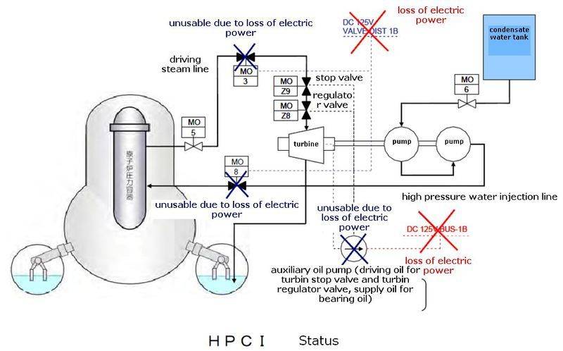

In summary: RCIC consists of a series of pumps, valves, and manifolds that allow coolant to be circulated around the reactor pressure vessel in the event of a loss of the main feedwater supply.In summary, the earthquake and tsunami may have caused a loss of coolant at the Fukushima Daiichi NPP, which could lead to a meltdown. The system for cooling the reactor core is designed to kick in in the event of a loss of feedwater, and fortunately this appears not to have happened yet.

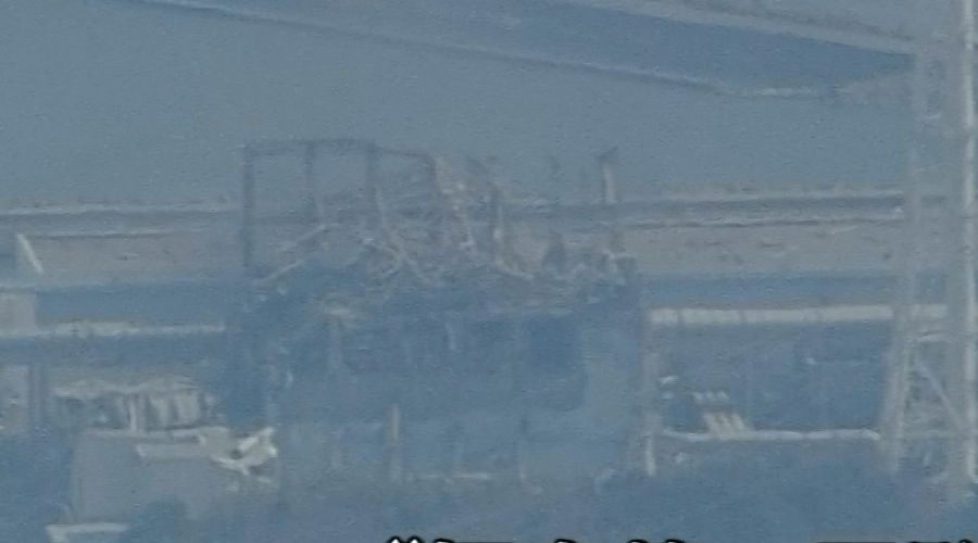

I believe the yellow "tank" you pictured in your unit 4 photo IS the reactor containment cap..that's just where it sits in the drone photo, if I'm not turned around, in NW corner.
i believe what i circled is further back and below that object you highlighted - i think i am seeing the round thing at lower left corner of your yellow rectangle , now covered with mud from rain and helicopter water drops..my unit 3photo shows only a little bit of its top.
Here it is in a March 16 picture of rubble pile before it got all covered with mud.
Two things are circled in red. Upper right is i think vessel cap, other is vessel head. Cap is obscured by a tree, that's why it looks broken.
i think the object you highlighted is the yellow-ish rectangle to right of my upper red circle .
I apologize for low quality. to get hi res see my longwinded writeup "A Couple Fukkushima Photos" at scribd < http://www.scribd.com/jim_hardy_9 > but just skip to last page where i give links to hi-res zip file.
the pictures are so blurry it's not possible to strongly assert anything.
Only reason i mention it is two photos from different angles generally agree.
and if the pressure readings from plant are true, it's not a possibility.
Still if you look at he radiation surveys of the plant there's a "hot" piece of rubble right where i have head. If it were something light surely they'd have moved it by now.
here's what a head looks like from underneath
and you see how perfectly round the lower object is.
compare this picture to survey maps...

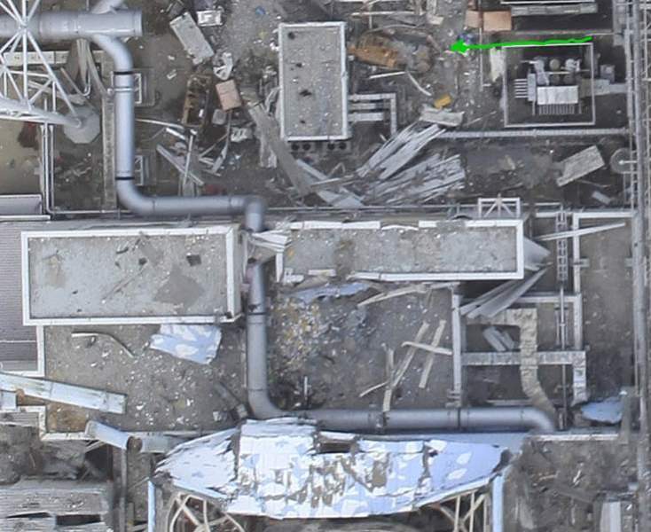

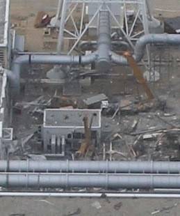

I looked for your "yellow tank" on an aerial photo of R3 and I believe I have found it. I compared its dimensions with the yellow reactor cap visible in R4. It seems to have about half to two-thirds of the size of the R4 cap, thus it seems to be something else.

The first 'leg' of your contention, that it is possible to 'see' that unit 3 reactor/containment caps are missing is exceedingly likely due to an illusion.
Because, it is exceedingly likely that what you _do_ see when looking at that area of the top of the building is largely the imprint of the overhead crane waggon, sitting on top of the two huge overhead crane traversal beams.
Here is a markup side by side, of the unit 3 rooftop, and a photo detail from unit 3 before the disaster showing the overhead crane parked close to the south wall of the building:
During the explosive events the overhead crane fell to the floor, ending up with its beams spanning across the reactor area, with the crane waggon crashing close to its center. These huge objects now very effectively block the view to the area underneath them, exactly there where the reactor shield and caps were situated in the intact reactor building. So, from mere inspection of this area in photos very little can be said about the current position and intactness of the shield plugs, and the RV and CV caps.

new picture of unit 3 with iaea team: http://www.tepco.co.jp/en/news/110311/images/110527_3.jpg
On the left we can see 2nd fuel machine, and big crane in center

Close-up of area :
http://inkers.nl/uploads/reactor-3.JPG

yes, it has already been discussed here and this looks like the machine that tensions the studs, this is even clearer with this view. This is what Jim was identifying as the RPV cover, but this is not.
We have also a better view over the yellow part that Jim proposed to be the containment cover but to me, it seems more to be a concrete part with some clear (and maybe yellow?) color...
we are real close together, Mr Tonio. I am looking NORTH of that cockeyed vent pipe on roof, you are south. Right hand edge of your rectangle goes over my object.
Here it is on a March 16 photo, very slightly different angle.. I put a rectangle around it like you did. Note relation to vent pipe.
It gets obscured in later photos. Small wonder with all the rain and smoke , not to mention the aftershock tremors of 18th.
yours is much higher quality than mine, i don't have knack yet.
Mine is in the zipped folder at
http://cryptome.org/eyeball/daiichi-npp3/daiichi-photos3.htm
and you have to unzip the folder referenced at top of that file
where it says
it unzips to a 1.02 meg jpg and i don't know why its so blurry. yours is sharper yet less bytes. After unzipping it's got name aerial-2011-3-18-14-50-0.jpg, one of ~30 photos. I made a folder for them.
do you have the link for your photo?
In the photo above one can plainly see the uncovered hole where reactor plug oughta be.
Later ones look like the hole is covered by crane. I blame that on aftershocks of 18th i think they were, do i recall a 5.5 ?

In the photo above one can plainly see the uncovered hole where reactor plug oughta be. Later ones look like the hole is covered by crane. I blame that on aftershocks of 18th i think they were, do i recall a 5.5 ?
Come off it. There is no evidence that the crane & its supporting structure fell later. Pay even half as much attention to photos that actually show stuff clearly as those that do not, and pretty much all of the features that interest you vanish.
Take for example your recent posts about the rubble on north side of reactor 3 building. There were already a number of other photographs which have enabled us to identify some things more clearly, things that don't match your analysis. And todays photos with IAEA delegation and reactor 3 provide further evidence that what you think you might see in the low res shot is not actually there, and no amount of internet discussion will change that. No reactor or containment caps.

It looks like a pre-cast construction method was used for the reactor building, at least for the upper part. That would explain why the columns got toppled that easily.
