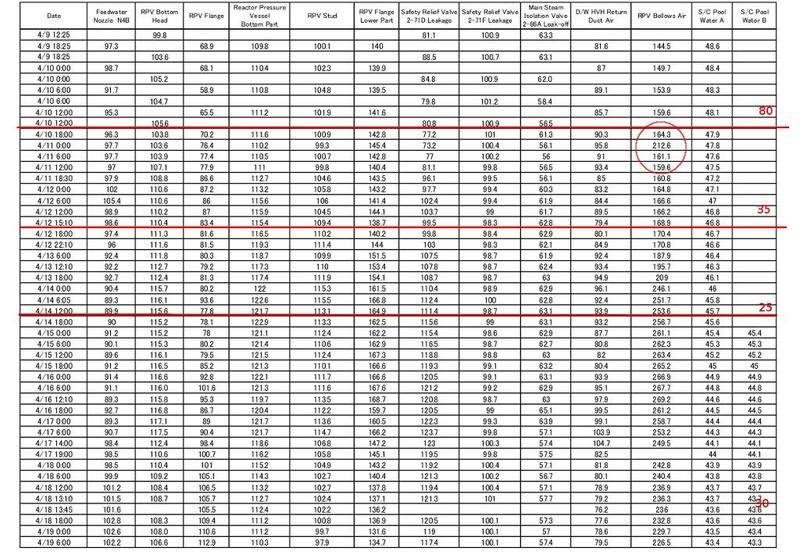

The pressure vessel of reactor 3 was is measuring 181 degrees Celsius at 5:00 am (JST).
Here is the link as reported by TBS News (Japanese): http://news.tbs.co.jp/newseye/tbs_newseye4745702.html

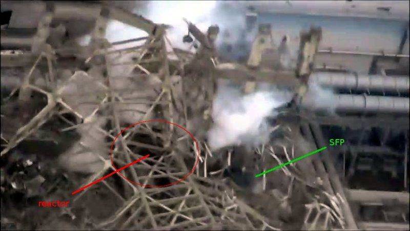

Interesting why they are installing this not in center of SFP, sfp is weakest there ?, the point where they are installing it is strongest I think (because of drywell thick): http://www.tepco.co.jp/en/news/110311/images/110607_1f_2.pdf
  • #9,225
Apparently they reduced the flow of water from 18 to 11.5 tons per hour in the hope of delaying the trenches from overflowing, as they are running out of options until the water treatment plant is up and running, but the temperature in the reactor appeared to rise as a result.
It also says that they are facing a difficult judgement as to how much cooling water to pump as they try to balance the risk of overheating the reactor vs overflowing the basements - "燃料を冷やすための注水量について難しい判断を迫られることになります".
The article does not say which way TEPCO are leaning, except to point out that to let the reactor get too hot would be a 'dangerous state of affairs'.
If you were TEPCO, what would you do?
