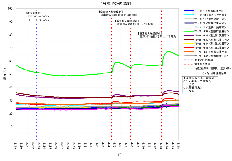

elektrownik said:
Here are some interesting plots, some of them show hight temperature >2500C, from where they take those data ? http://www.kantei.go.jp/jp/topics/2011/pdf/app-chap04-1.pdf
Ostensibly, those are the results of calculations made with the MAAP code. The maximum temperature is about 2800C, the melting point of UO2.
From the English version
In addition, in order to supplement this limited information, TEPCO carried out analysis and evaluation of reactor situation of Unit 1,Unit 2 and Unit 3 using MAAP, which is a Severe Accident Analysis Code, based on gained operating records and parameters. The results were reported to NISA on May 23. NISA carried out a crosscheck by using other severe Accident Analysis Code, MELCOR in order to cross-check for validation of TEPCO’s analysis with the assistance of Incorporated Administrative Agency Japan Nuclear Energy Safety Organization in order to confirm the adequacy of the analysis and evaluation concerned by using MELCOR, another severe accident analysis code. The report of analysis and evaluation conducted by Tokyo Electric Power Company is shown in Appended Reference IV-1, and analytic results by crosscheck are shown in Appended Reference IV-2.

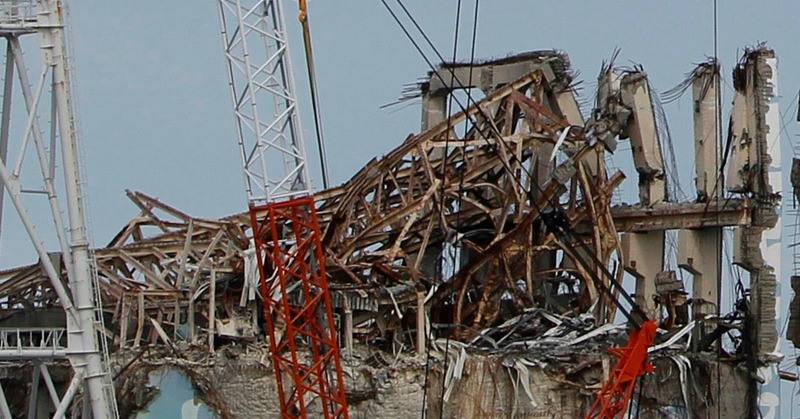

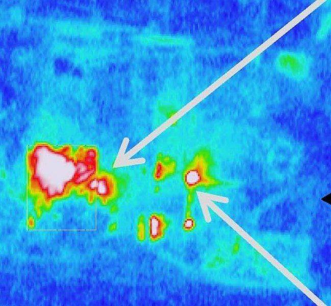

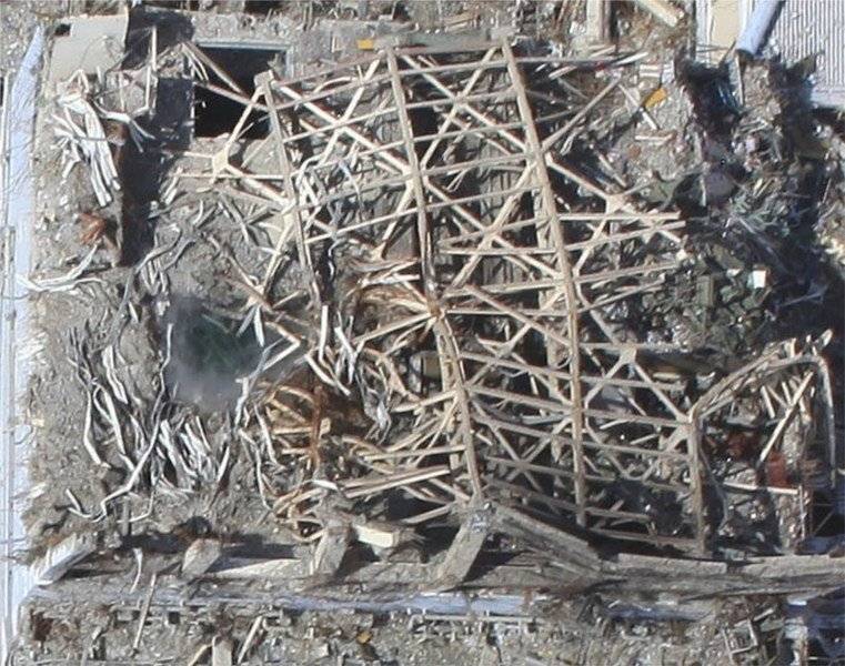

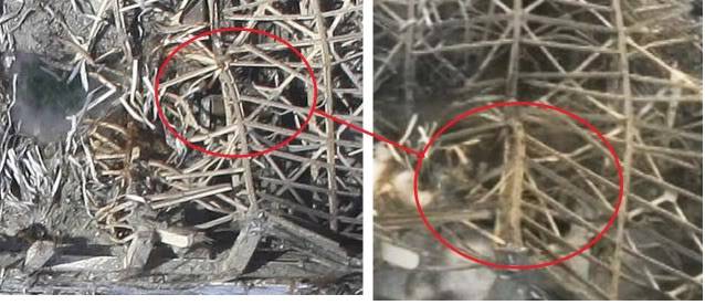

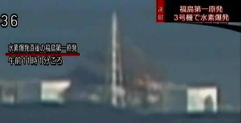

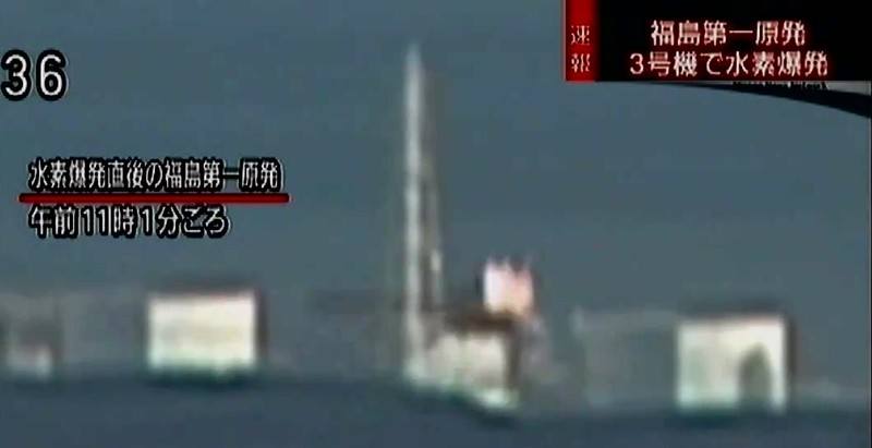

Intriguingly the Report of the Japanese Government
to the IAEA gives off this new bit of information regarding the explosion at unit 3:
"Along with the explosion, the oil for the MG sets for the control of the rotating speed of
recirculation pumps burnt concurrently at the heavily damaged west side of the 4th floor
of reactor building."
I am left wondering how it could possibly have been determined, that a fire was ongoing -- concurrent with the explosion -- in the oil of the recirculation flow control system M/G sets.
If they eyeballed a fire at that location once the initial dust from the explosion died down, they may reach that conclusion.
