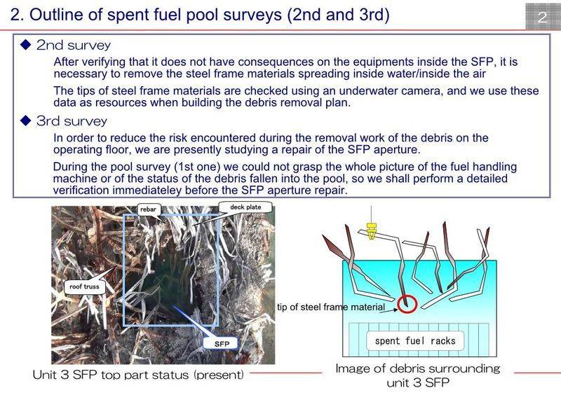

Joe Neubarth said:
The debris was scattered on top of the fuel assembly tops. They all looked in place to me. The rectangular patterns are quite distinctive. The only thing is that we only saw about two - three square feet of the top of the assemblies. The key in the video is to look quickly at the very beginning. As the bubbles come up and block the lens you can see the pattern of the top of the assemblies at the top and left of center. That rectangular pattern was consistent with the pattern in the reactor 4 SFP.
http://www.dailykos.com/story/2011/05/11/974605/-Up-Date-with-SFP-3-Video
The blog you linked to says
Hard to tell if there's any damage to the fuel assemblies when you can't see them for all the rebarb, concrete, cables and other crap.
and I agree with that. I just re-watched that video again and I can't see anything anywhere close to what you're describing. I looked at the very beginning, where the bubbles come up and impede the view. I don't see any rectangular patterns at all. Perhaps you could post a still frame from the video and circle the rectangular pattern you see.
MiceAndMen said:
The blog you linked to says "Hard to tell if there's any damage to the fuel assemblies when you can't see them for all the rebarb, concrete, cables and other crap." and I agree with that. I just re-watched that video again and I can't see anything anywhere close to what you're describing. I looked at the very beginning, where the bubbles come up and impede the view. I don't see any rectangular patterns at all. Perhaps you could post a still frame from the video and circle the rectangular pattern you see.
I believe the original reference was to this:
I think Joe means starting at 0:27 if you look in the upper left corner you see the top of a few of the fuel assemblies. I'm with the dkos user and MiceAndMen here; I can't tell much of anything about the state of the fuel from that brief imagery.
I also didn't feel I could tell much about the actual state of the assemblies in the SPF4 video either. The tops of the assemblies seemed to be somewhat intact. Can't draw conclusions about lower down where the fuel itself is, but at least it wasn't all in shambles.
