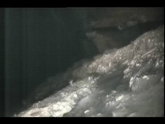

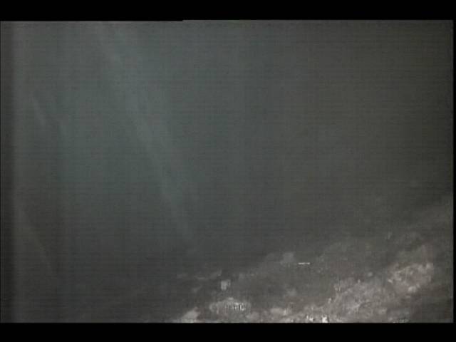

Thanks very much for the translation tsutsuji.
Documents in english related to the subsequent reactor 2 investigation (after that water sampling one) are available in english now: http://www.tepco.co.jp/en/nu/fukushima-np/handouts/2013/images/handouts_130812_06-e.pdf
As usual the image quality is rather poor and the ambient dose info obtained isn't released yet. I wonder when they hope to do the actual investigation of the pedestal area, using penetration X-6 instead of X-53.
  • #14,095
SteveElbows said:
As usual the image quality is rather poor ...
Once they release the video of the investigation I plan to look after that.
  • #14,097
Not much can be done with the images I'm afraid:
- they are using some kind of filter to remove the worst of the radiation 'hits': this filter is interfering with the averaging
- they did not show the most interesting places/did not checked the interesting places
- the light is still low
Anyway, at least the noise could be removed.
