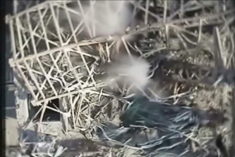

MadderDoc said:
However note that '4' , photographed in a perpendicular to direction to '3', and at some distance from it, is the lower NW end of the north face of the bridge, which on the intact machine was mounted just above, and only a meter away from the track guide. Indeed the video of '4' shows the flange through which this corner was connected to the frame piece that is/was mounted on top of the track guide (albeit the mounting flange now looks sadly beaten up, de-bolted and without its partner)
But I'd expect the bridge of the crane to run across the pool east-west, and so the arrow is pointing along that east-west span where the bridge (4) would be found. That may be all they're saying with the arrow, that "The bridge (4) is along here."
A question the map doesn't answer is: is the track guide (3) (which would be at an end) on the low or high end? Assuming, as size-logic would suggest, that the crane rests at around a 45˚ angle along the elevation axis. My sense is 3 is on the low end, and notice that the lighting on it is about the same as on the fuel rack (2). What I believe it be the trolley's upper deck is on the east side and thus should be on the high end of the crane and 3 on the west-side low end.
I think, what they are saying with the arrow is that the photo has been taken in the indicated direction relative to the indicated cask area, i.e. towards east from that face of the cask area. And specifically it is from _outside_ the cask area area, if I haven't got this wrong, I translated me to that bit from one of the Japanese versions of that photo montage, which specified in the same manner that the photo of '3' has been taken towards south, and from _inside_ of the cask area). The gate in the SFP3 cask faces south in the only photo I have of it, so that fits , although one may wonder whether the cask area is still intact and good looking.
I wouldn't dare much of a prediction on where the different parts of the FHM are hiding, It has suffered way more damage and breakage than I imagined, after I stopped believing in ballistic FHMs :-) Even the long bridge -- which I previously felt had to be nearly indestructible, appears to have been split longitudinally, so there you may have it: those long beam constructions may be tic-a-toe in the pool. Then what would it mean what is high and what is low, if it is just a mess.
However, it remains likely, in my mind, that several parts of the trolley, (I harbour no hope whatsoever of finding it in one piece),ae in that part of the pool you've been doing much work on.
BTW, could what we are seeing there close under the surface be the _bottom_ frame of the trolley, that one with the wheels? I feel I have been everywhere else high and low on the FHM looking without finding a match, only this stout frame remains, it is so well hidden, that I can't see enough to dismiss it as a possibility.

Sfp3 fhm
Here's a collage from this SFP3 video. I see what I think may be railing with metal fencing from the trolley, as pointed to on the right. And what might be the bottom of the trolley platform just above / beside the smashed-down crane bridge.
Any ideas on what's the large flat object that's smashed down across the crane's bridge? This is a pretty dramatic aspect. An easy guess is that it's a panel of the exterior wall. But it's difficult to understand why it would be there, since I believe most of the upper-deck wall panels got blown outwards and turned to rubble. So why, if it is a wall panel, would a wall panel be found on the north end of the pool? But if it's not a wall panel, what the heck is it? It seems to big to be the trolley. Perhaps some east-side wall panels fell inward. And yet there seems to be other large objects on top of this possible 'wall panel'. What a mess to figure out!

  • #13,008
MadderDoc said:
The gate in the SFP3 cask faces south in the only photo I have of it...
I don't understand what the SFP cask is, can you show that photo? Is it a fuel rack? I thought they eventually put fuel in dry casks, but I didn't know there are casks in the pool but have seen this noted here and there w/o imagery.
Did you have in mind the thing I point to in my collage above as the trolley's base frame? It's not a perfect match for anything caught in the limited pre-tsunami imagery we have, but it's intuitively close. Now more than ever I agree with being confused as heck about where the FHM parts are. I still these parts have strong signals of being the upper deck, but how what looks like the bottom frame of the trolley can be deep down, but the upper deck above water. I just have to shrug my shoulders and say WTF?!
Certainly the FHM in Unit 3 took a horrendous beating! :eek:
  • #13,009
SpunkyMonkey said:
Great photos tsutsuji, thanks!
The probe camera makes the passage way seem much longer that it is. Curiosity, seeing the hatch passage better at the moment only makes me more confused about the video therein . :confused:
OK, so using measures from the diagram, now with regained trust from those fine photos, we have this cylindrical room of the hatch clearly defined. Geometrically, it is a cylinder of height 0.90 m. and diameter 3.050 m, lying at its side, and it has a horizontal insert to produce a platform, which according to the diagram is at a height of 0.385 above the lowest part of the cylinder. And with a bit of math .. inside he hatch we'll have approximately 7 m2 of hatch inner plate to potentially look at, about 8 m2 cylindrical wall, and 1.8 m2 floor platform. Most of which, according to Tepco, we have not seen in the video, although again according to Tepco we do see parts of the platform, or floor.
Also, I am pretty sure, we see parts of the cylindrical wall as well as parts of the inner plate. Starting with the inner plate, we see it most closely in connection with the filament like artefacts. The inner plate presumably has been painted with the same paint as the rest of the room but it has degraded differently due to heat, presumably. From there we also see the inner plate meeting the wall and/or the floor (I believe we see examples of both). One might expect a similar peel off of paint at the walls and perhaps at the platform close to the inner plate, but wet corrosion there steals the show. We see a patch of something looking as cracked steel, all rusted up and wet, I believe that is on the floor, but it cannot definitely be said to be a crack, it could be just a bad wet rust problem looked upon up close. Alien looking stuff, for sure.
The slit at the floor between the platform and the inner plate produces a narrow trench, where water from a leaking flange would run into and accumulate, connected to the trough like cavity under the platform, where water would similarly accumulate. The scope does not enter the latter cavity, but it appears to have high interest in the corrosion along the slit at the inner plate. My 0.02.

  • #13,016
westfield said:
MadderDoc could you check that Cask area image link - it's not working for me and it appears to point to a private IP address range.
Right. Here it comes:
