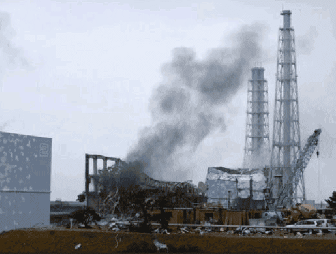

REGARDING THE INITIAL EXPLOSION OF BLDG 3
1) |Fred's earlier observation that the roof of Bldg 3 seems to implode before the blast is correct
2) The initial fireball (Boom) isn't a fireball -- it is a pure, white puff of steam or smoke that only ignites after entering the outside air. After that, it doesn't expand or blow outward, it just seems to burn up and consumes itself. The building explodes next. The vertical plume of dense smoke is the final visible event. I haven't matched each of these to the boom, boom, boom sounds, though.
Each frame = 1/30th of a second (--15.png is at 15/30ths, or 1/2 second after --1.png)
http://i306.photobucket.com/albums/nn270/tcups/Fukushima%20Foto%20Files/Picture1.png
http://i306.photobucket.com/albums/nn270/tcups/Fukushima%20Foto%20Files/Picture2.png
http://i306.photobucket.com/albums/nn270/tcups/Fukushima%20Foto%20Files/Picture3.png
http://i306.photobucket.com/albums/nn270/tcups/Fukushima%20Foto%20Files/Picture5.png
http://i306.photobucket.com/albums/nn270/tcups/Fukushima%20Foto%20Files/Picture15.png
There is much more information in this audio and video to be extracted! Wish I had better video skills.

TCups said:
... the roof of Bldg 3 seems to implode before the blast ...
You must be aware that MPEG and JPEG compression add very complicated artifacts to the frames. Roughly, each 8x8 pixel block is "simplified" independently of the other blocks. So one gets blurring and/or spurious streaks within each block, and spurious sharp edges between the blocks. For MPEG there are also complicated tricks to simplify apparent motion, that generate more artifacts when you try to grab a single frame. The video was recorded at high compression (= low quality) so these artifacts are quite strong. To make things worse, an edge-enhancement filter was used before compression --- which adds its own artifacts, such as spurious "grains" and "echoes" along sharp light/dark boundaries. Unfortunately, most of this damage is irreparable, since no filter can restore the information that was lost in the encoding.
For example, although the reddish flash spans a dozen pixels across, the video does not record any detail about its position, shape, and texture. The flash basically got simplified to one or two very bright 8x8 squares, with no internal detail; and that is all we are ever going to get.
What seems to be "the roof caving in" could also be a ring of black dust being blown horizontally al around the building, along the edge of the tar/cement roof, as the latter begins to be lifted off the underlying metal framework. This ring of dust becomes wider in the succeeding frames, covering more and more of the wall, from the top down.
I believe the rising column and mushroom is just a late convection artifact (i.e. not thrown out by the explosion, but lifted by buoyancy.) Like the mushroom of a nuclear bomb, or of a large gas tank explosion.

  • #3,136
I have converted video to different formats and went frame by frame . What I think your seeing is the walls expand at the same time the fireball starts to eject . The roof seems to travel down at this point then explodes upwards with everything else and fireball is sucked back into upward explosion . A lot of the dust in this explosion is pulverized concrete. Thats why you don't see more of it laying around. Some of the large pieces fell between Unit 2 and Unit 3 onto the building attached to Unit 3. There is a mirage also in the video because it was taken at such long range that makes the structure move some .
When looking at frames 3, 5 and 15 I realize we are not looking at an explosion extending to the left of the picture but at a well known problem of an overexposed and saturated CCD pixel effecting the next pixels that are read out serially. Therefore the explosion extending to the right of the building could very well be a electronic recording artifact.
Further you will note the black line next to white surfaces - this is an electronic artifact from the image sharpening process and these are one or two pixels wide.
That a hydrogen explosion is followed by an implosion I have speculated in https://www.physicsforums.com/showpost.php?p=3199497&postcount=641"
I now have found the proof in this document http://www.gexcon.com/doc//PDF files/Middha_Hansen_CFD_09.pdf see pressure graphs page 3 of 8

  • #3,143
'tiz true -- resolution won't improve, and compression sucks detail out of the image. I am much more in tune with the effects of lossy compression in still photos and high resolution digital gray-scale images than I am with video that is low resolution stuff from the start, but I suggest that if not the detail, then the overall general motion and time frame of the motion are preserved in the context of a frame to frame analysis at 1/30 rate.
Also, compression artifact isn't what turns the initial white puff into red. Only heat does that. And though shadow and compression artifact play hell with the fine details of what is in the vertical smoke plume, there is very little doubt that a whole pile of garbage is falling out of it, streaking ground-ward in later frames.
Convection may cause billowing mushroom clouds and waft smoke and dust and water vapors aloft -- some of that is certainly going on; however I, for one, doubt rising heat alone will casually toss large, heavy chunks of debris almost straight and then quickly drop them on and around the building. It takes significant mechanical force and the impulse of a blast to accomplish that.
As for the "imploding" roof effect, I suggest (agree with you that) it seems equally plausible, and perhaps even likely, that the apparent downward roof movement is neither compression artifact nor implosion, but perhaps instead the visual effect of the sides of the top floor being blown outward and down, surrounded by dark smoke. When examined very carefully, there almost seem to be some horizontal contrails coming from that blast, too.
All great fun to sift through and speculate over. It is going to be even more interesting if I can get the audio track, pitch adjusted for slow motion, synched with the video. There are a bunch of very weird mechanical noises coming from that clip, too.
PS: I tried as best I could to hold to on-screen resolution when I grabbed the individual frames so as not to degrade the image further. I confess that I not too familiar with the .png format or loss of detail from a screen grab in .png format being re-displayed at the same on screen resolution. Side by side with the original video on screen, the reproduction seems true.
PPS: wiki says .png is lossless, bitmapped

REGARDING COMPRESSION ARTIFACT AND RESOLUTION
Just for grins, here are the actual pixels I am able to resolve, not from the video, but from the links to the frame grabs I posted. ROI is the initial white puff and red fire ball.
http://i306.photobucket.com/albums/nn270/tcups/Fukushima%20Foto%20Files/Picture2-1.png
http://i306.photobucket.com/albums/nn270/tcups/Fukushima%20Foto%20Files/Picture3-1.png
http://i306.photobucket.com/albums/nn270/tcups/Fukushima%20Foto%20Files/Picture4-1.png
Not great, but more than 8 pixels for sure. Plus the tower just to the left will give an idea of edge artifact and contrast resolution.
The MPEG format encodes motion in a complicated way. Extracting a frame requires non-trivial interpolation and may add motion artifacts. (For instance, in extreme cases a spot that moves steadily at 2 pixels per frame may be encoded as a spot that moves 6 pixels in one frame and 2 pixels backwards in the next frame. When played at normal speed the eye sees only the average.) Saving each frame as a .png file prevents *additional* loss but does not recover what was lost in the JPEG/MPEG encoding, and retains all the artifacts of the latter.
TCups said:
Also, compression artifact isn't what turns the initial white puff into red. Only heat does that. ... there is very little doubt that a whole pile of garbage is falling out of it, streaking ground-ward in later frames. ... rising heat alone will [not] casually toss large, heavy chunks of debris almost straight and then quickly drop them on and around the building. It takes significant mechanical force and the impulse of a blast to accomplish that.
I think so too.
