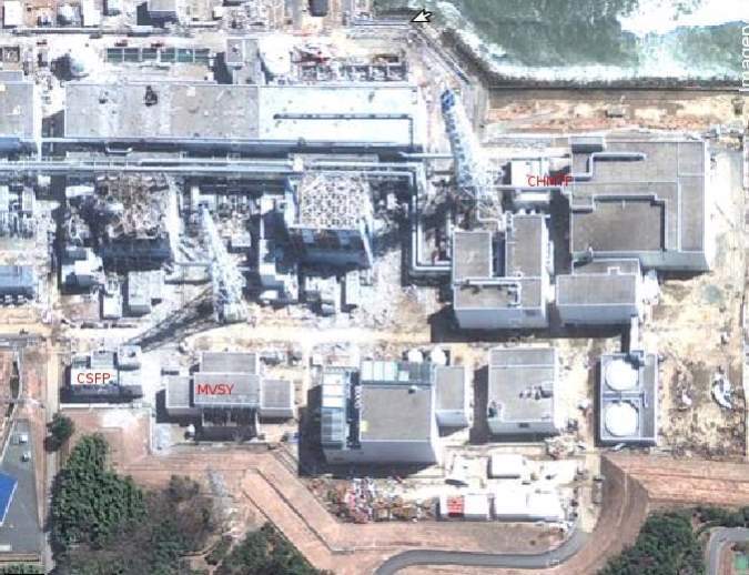

I haven't read physicsforums during this three-week period, instead I was in a company of Russian nuclear engineers & Chernobyl liquidators, and you better take my word for it, when I say that they are still scarred by the accident of April, 1986 and wouldn't want the events that I've mentioned to have taken place.
There was steam, as well as black & grey smoke coming out directly from the RPV during the first week, much later the SFP South of it began to give off steam. The "(70degC)" figure you're quoting is from the Ministry of Defense of Japan operation with CH-47 hovering 3000 feet above the plant, facing West and taking those thermal images - their press releases contain those figures with hilarious arrows pointing who-knows-where, they might as well be pointing to a bucket full of liquid nitrogen.
First week photo Unit 3:
Second week
No water in the containment or RPV on the 2.5-3rd week inside reactor 3, SPF steaming, tho:
Fred, N-S line runs along the coast, please sort out your directions, before replying.
Unit 4 blown hole: http://img84.imageshack.us/img84/810/unit4sfp.jpg

Sirius (b) said:
Thank you, I'll pay extra attention to my directions. Now, in red the hole that you pointed at in your earlier post .
Concerning it's location it is S/N on the west part of the unit 4, and according to the photo it is on the level just bellow the operating floor and not bellow as you state, it would match the isolation condenser level that I mentioned earlier if we assume blueprint are accurate for this point on unit 4.
There is no crossing of fuel storage located (in blue) as it is located on the east part of the building
[PLAIN]http://i.min.us/ikC5W8.jpg
