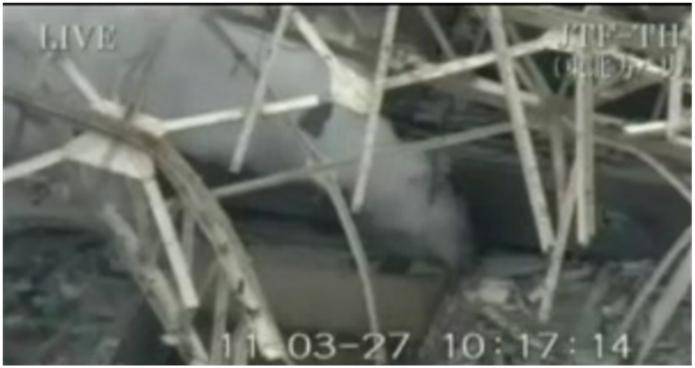

curious11 said:
What is this feature? It looks like the top of a whiskey distillery. Note the round opening at the top.
If it is indeed the the top of the reactor it is in the wrong place, suggesting the reactor was destroyed by the explosion in building 3, which has been my "best guess" for some time.
Sorry if this has already been commented on; I've been away for a few days.
  • #1,128
I think that the round feature is the top of the tank just above it

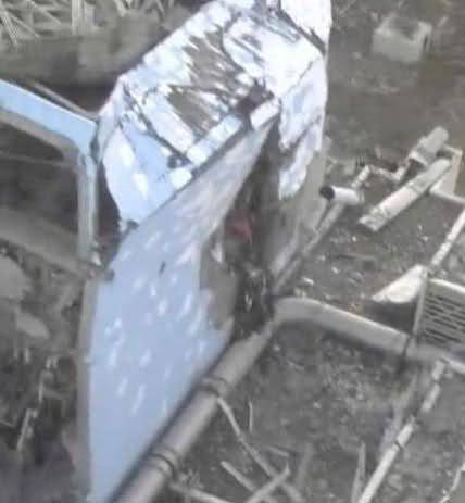

artax said:
and is it currently snowing over there or is that stuff emanating from the reactors?
IMHO it is snowing, it is visible both in closeups and in some more general views. After all it is March 23rd, so nothing unusual.

I would like to draw your attention to a last remark i just made (and it probably answers a question I've had for some time looking at the images of the ruins of the reactors). Looking from outside of the reactors, we assumed maybe that they are centered in the middle of the reactor building. I've seen variations on the differents schematics that have been posted around but if the drawing that the scientist from Tokyo University showed at the NHK is correct, which i believe it is, then it confirms that THE REACTOR IS NOT AT THE CENTER OF THE BUILDING VIEWED FROM THE TOP, but pushed towards the turbine building (because the east side of the torus below the ground is actually below the connecting building and not below the reactor building). So the reactor head is shifted towards the East (toward the sea).
Now we can try to speculate if the smoke plume from this building is coming from this place or not, but if think it is (satellite picture just after the explosion, 14th or march):
http://www.netimago.com/image_182152.html
http://www.netimago.com/image_182153.html
