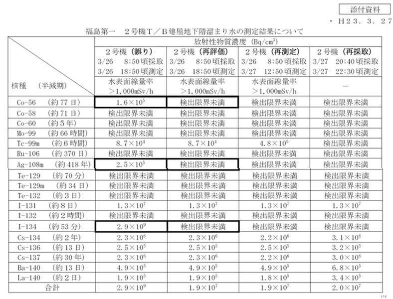

NHK reported that water in basement 3 has 10000 x the radioactivity as the water inside a normal operating reactor, hence the assumption that unit 3 containment may be breached, leaking water into basement 3.
This is the slide displayed while above was being reported.
This slide also confirms to me that the design parameter of a 5.7m Tsunami wave was an afterthought. The height as I in a previous mail suggested is determined by design need to keep basements above seawater levels as can be seen above That height dictates a maximum Tsunami wave such that pump cabins for coolant do not get destroyed. Ground level at reactor is about 15 metres as per earlier Tepco releases.
Could one not just as easily conclude that the contamination comes from damaged fuel rods in the SFP with the leakage coming from the damaged SFP, or from dispersed fuel rods outside of the SFP that had been spayed with water over the last several days?

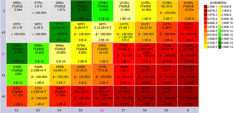

Nobody has commented on my analysis, so I'll post it again. I was honestly startled.
Bodge said:
The IAEA have just measured very high beta/gamma contamination 4,900,000 beq / metre squared in Fuk. Pref.
"At distances between 30 and 32 kilometers from the Fukushima Nuclear Power Plant, in a north westerly direction from the site, dose rates between 16 and 59 microsievert per hour were measured. At these locations, the results of beta-gamma contamination measurements ranged from 3.8 to 4.9 Megabecquerel per square metre. At a location of 21 km from the Fukushima site, where a dose rate of 115 microsieverts per hour was measured, the beta-gamma contamination level could not be determined."
http://www.iaea.org/newscenter/news/tsunamiupdate01.html
Here is a map of Chernobyl's "Zone of Alienation"
I converted 40 curies / square km to 1.48 Megabeq / square metre
Also 1.48 is mentioned here:
http://books.google.com/books?id=g3...age&q=chernobyl cs soil contamination&f=false
We seem to have 4.9 Megabecquerels in Japan
edit: Forgot to mention not all of the radiation detected yesterday by the IAEA was from Cs137, there will be Iodine,Strontium,Cobalt etc and maybe Plutonium too. Also one site was "unmeasureable", but mSv was highest at that point !
Makes more sense to me as water does not flow uphill - see basement levels of torus and turbine building of slide posted earlierTCups please note location of reactor relative to upper structure
If the original data are correct and your analysis of the data is correct, then, the obvious comment is "gee, that is really hot!"
Do we know which were the source of the radionuclides emitting that level of radioactivity and how long their half lives are? If these represent the volatile components, brought to ground by rain or settling dust, for example I-131 with a half life of 8 days, then the radioactivity will be very different a few weeks from now. If, on the other hand, there are longer half-lived fission byproducts from the damaged fuel rods in the core or SFP, then the contamination will by its nature, be much worse and a much more long-lasting problem. Chernobyl was the later. As far as is yet know, Fukushima will be the former.
  • #1,095
The IAEA simply had this to say:
"Measurements will be taken to determine more precisely the actual radionuclides that have been deposited."
  • #1,096
What do you make of the fact that the exposure took place inside the turbine building that had debris smash through its roof after the explosion?
  • #1,097
I don't know for sure. On consideration, though, if the exposure were from pooled water in the building floor, it seems more likely that the contamination came in with the water, not from falling debris. That said, I believe there might have been rain there. Rain or sprayed water leaking through a large hole in the roof could easily be one route, if not the main rout for water accumulating in the building, versus, for example, ground water seepage from a crack in the foundation.
What do you think?
